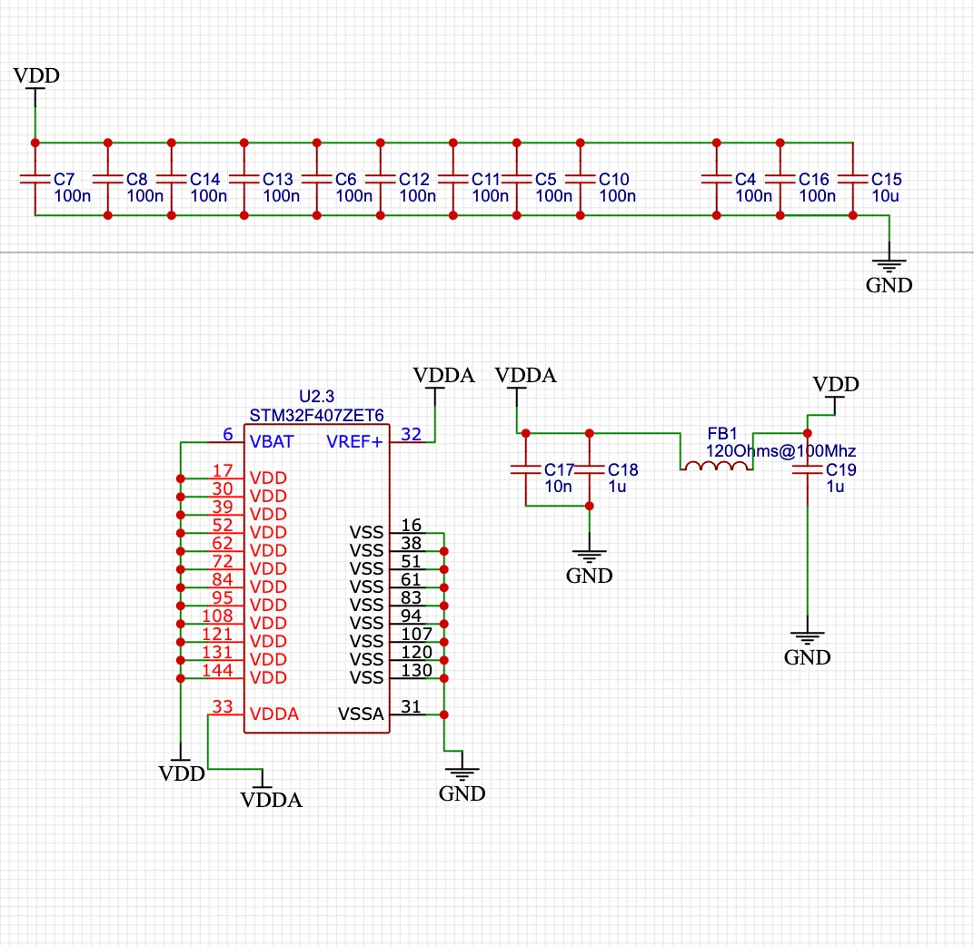

Is this decoupling configuration for the STM32F407ZET6 correct
Hello im creating one of my first stm32 boards and need some help ive watched many tutorials about decoupling capacitors and have referenced what i could from the datasheet could anyone confirm if this decoupling setup would work or if modifications are needed:grinning_face:. I am using a usb-c connector for programming and power with an ams1117 3.3 volt regulator with the appropriate solid tantalum capacitors. For a little more info these are all smd 0603 capacitors and the component marked fb1 is a ferrite bead with a resitance of 120ohms at 100mhz.

Should work just fine. The ferrite bead isn't necessary if you aren't very concerned with analog performance.
Through an STLINK-V3MINIE? Note that connecting USB directly to the chip itself won't allow for debugging.
For general reference, in case you haven't seen it:
https://www.st.com/resource/en/application_note/an4488-getting-started-with-stm32f4xxxx-mcu-hardware-development-stmicroelectronics.pdf

Unless my eyes are playing tricks, it looks like you have 12 VDD pins and 11 0.1u bypass caps.  Probably best to make sure there is a cap on each VDD pin.

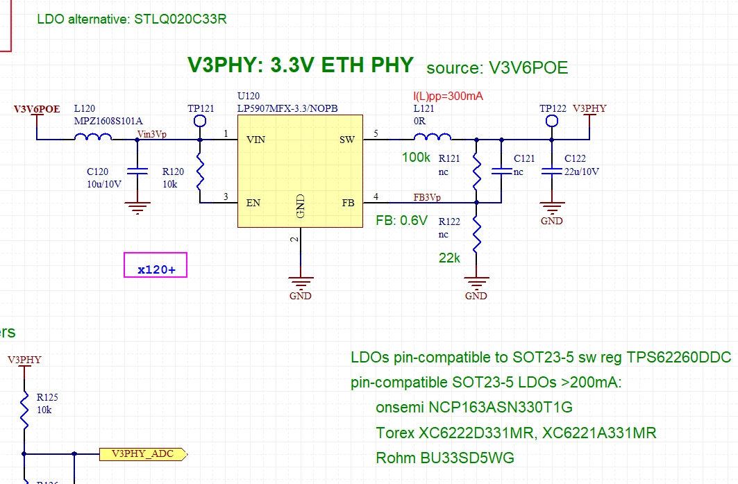

Anyway, even for space reasons I would check what the max. current requirement is, then decide if a switching regulator makes sense - or even if a SOT23-5 LDO might be enough.
Interestingly, there are almost pin-compatible LDO / buck regulators in SOT23-5/6 out there, so for some designs I basically put the buck circuit on the board, but if an LDO was good enough, I just bridged the inductor:
