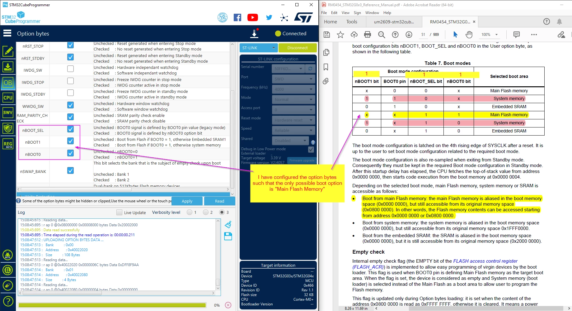

It's either the application was not flashed or unstable BOOT0 input - the bootloader is invoked instead of your application

The problem is that I have the option bytes configured to not care about the BOOT0 input (see screenshot below). From my research it seems like this should be impossible?

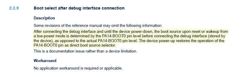

Actually, I just figured out why this behaviour was occurring. This is from the STM32G030F6 device errata sheet:
I fixed it by:
  • Flashing the app I wanted to debug
  • disconnecting the debugger
  • power cycling the pcba
  • connecting the debugger (after app had already launched)
  • now I can reset/reflash etc. as expected
