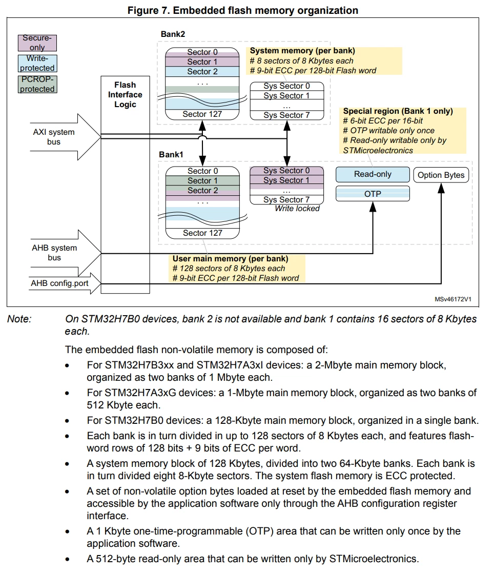

Is this an Error in the STMH7B3xi Datasheet?
Section Memories
The Flash memory is organized as follows:
• Two independent 1 Mbyte banks of user Flash memory, each one containing 128 user sectors of 8 Kbytes
each.
• 128 Kbytes of System Flash memory from which the device can boot.
• 1 Kbyte of OTP (one-time programmable) memory containing option bytes for user configuration
Shouldn't this read:
• Two independent 1 Mbyte banks of user Flash memory, each one containing 8 user sectors of 128 Kbytes
each.
