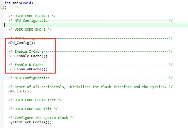

Is this a bug in cubemx?
  • November 18, 2017
  • 819 views
Posted on November 18, 2017 at 09:37
generate code project ====>
The initialization function actually inside the main function。

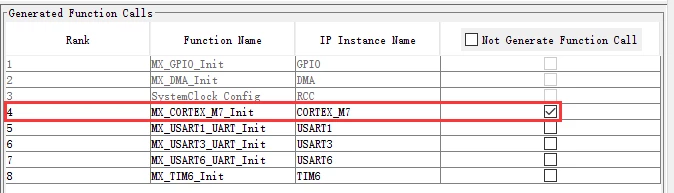

    Posted on November 20, 2017 at 09:29
    Hello
    v.v.010
    I checked with CubeMx 4.23 and t
    he initialization functionisnot generated.
    Please use the last version of CubeMX 4.23, then if you have again this issue, please share your ioc fileto check with you.

    Posted on November 22, 2017 at 05:00
    So strange! My project was built with the older version of cubemx (version seems to be 4.22), will have this problem after upgrading to the latest 4.23 version. I just used cubemx (4.23) to build a project that does not really have this problem. Thank you for your reply!
