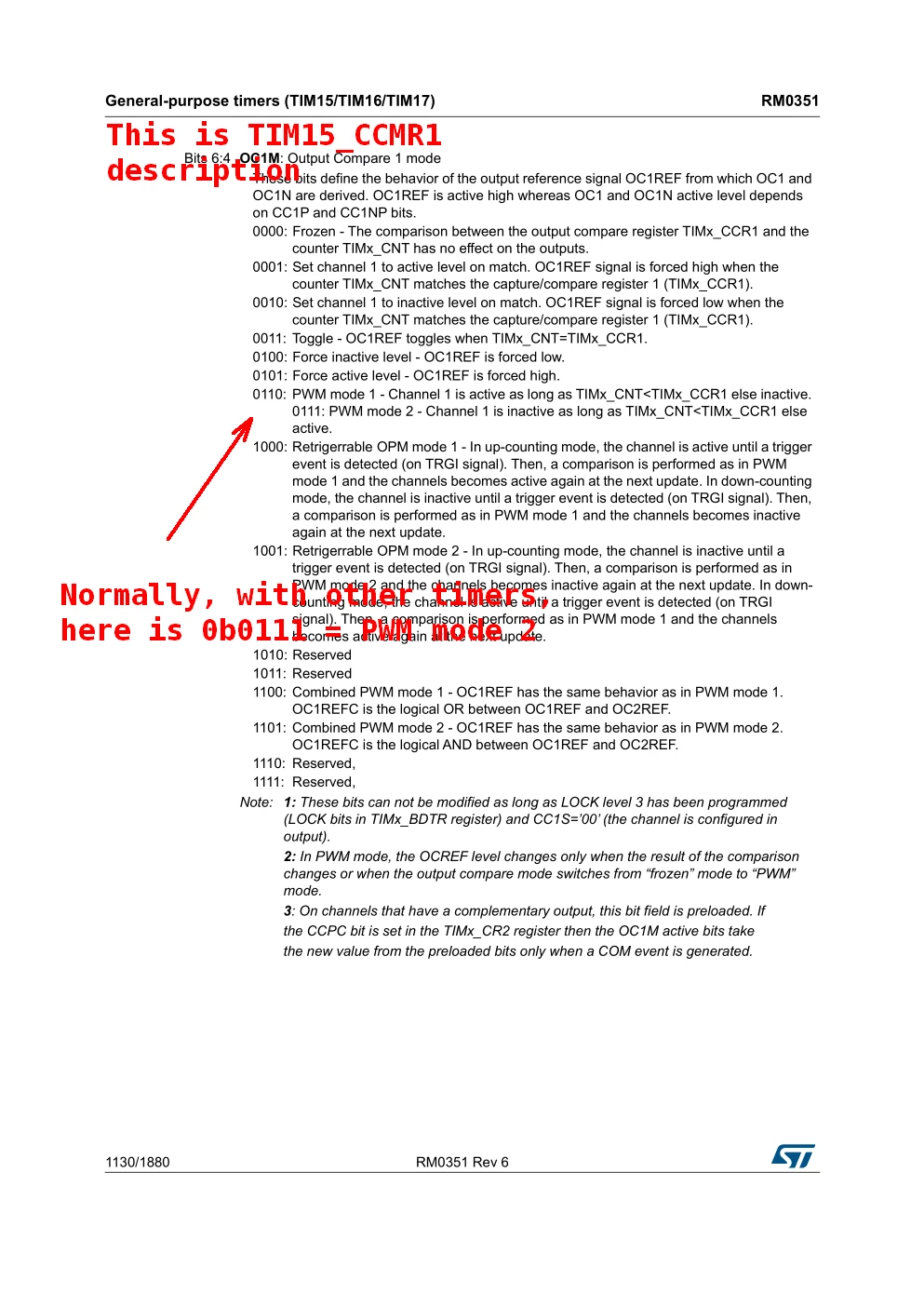

Ok, this noted for fix.
Thanks,
Imen

Look at it again, it's right there, just the indent is wrong.

Oh.
Indeed.
Thanks, @berendi​ .
Then, the indent should be fixed... :)
