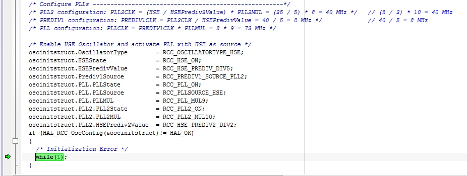

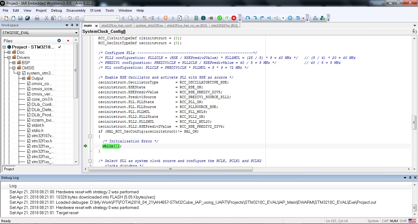

    . Now I am using STM32F103RE that has 64k ram. But when I configure its clock, debugger gets struct in while loop at
    if (HAL_RCC_OscConfig(&oscinitstruct)!= HAL_OK)
    /* Initialization Error */
    while(1);
    Please check the following modification for 8 MHz HSE. Am I doing it wrong?
    I am using following IAP example
    .\AN4657-STM32Cube_IAP_using_UART\Projects\STM3210C_EVAL\IAP_Main\EWARM\STM3210C_EVAL\
    Ahmed.Waqar
    Apr 21, 2018 10:46 AM UTC
    Posted on April 21, 2018 at 10:46
    Even it is getting struct with following configuration as well
