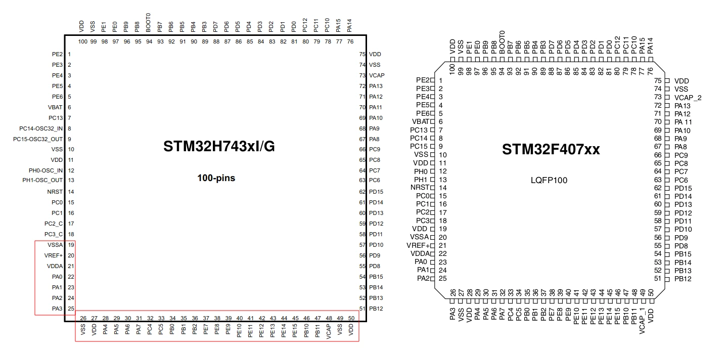

Is there any STM32 F7 or H7 pin compatible with STM32F407VGT6 - LQFP100?
I was very disappointed to note that STM32H743VIT6 is not pin compatible with STM32F407VGT6 in the LQFP100 enclosure.
It would be nice if MCU F7 and H7 could replace F4, without having to redo the PCB board again.

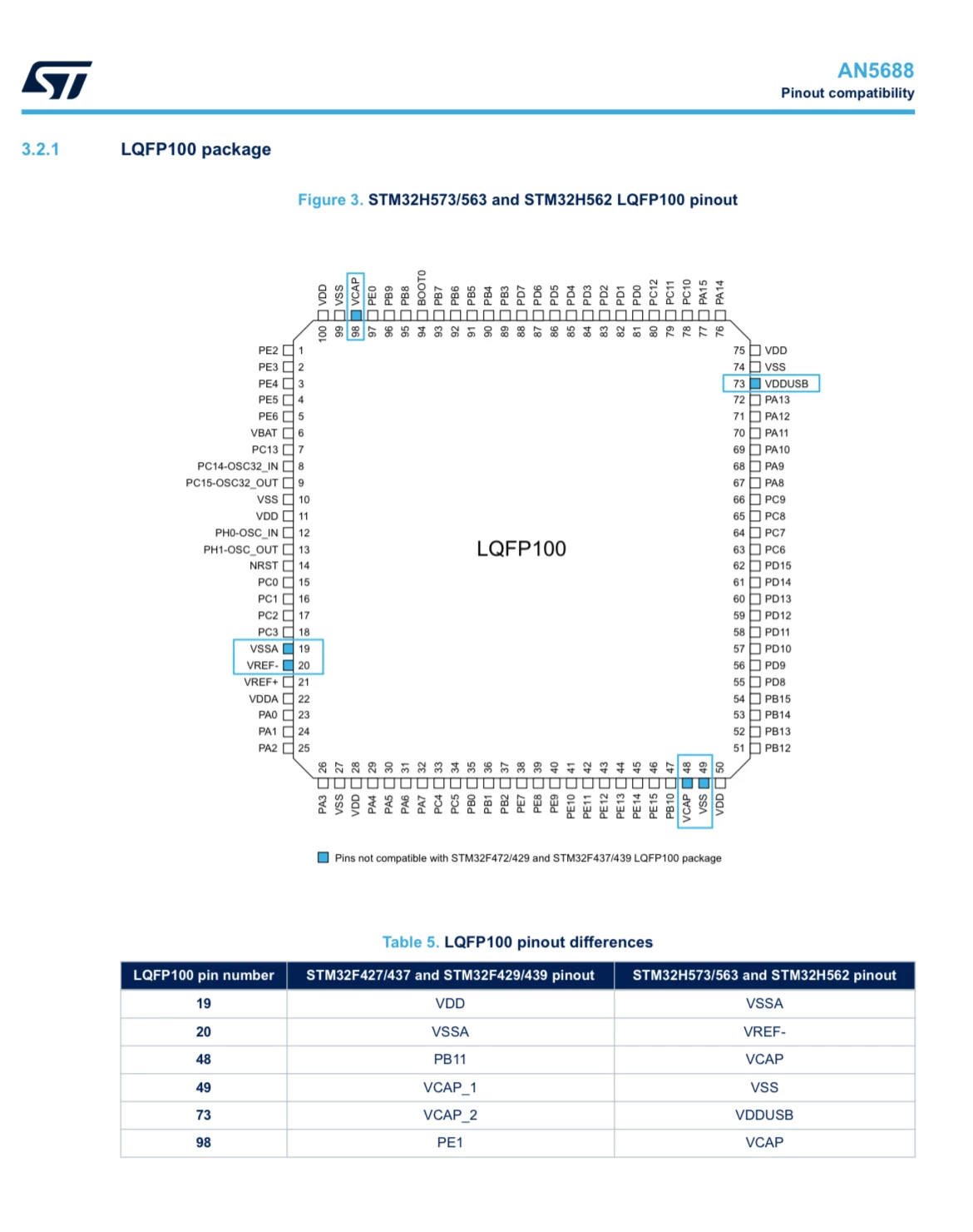

Dear @RhSilicon ,
Unfortunately it is not possible from F4 to H7, here is the last series we released STM32H5 with Cortex-M33 secure core instead of M4 core and this is below the best we have done to keep pin compatibility ( strongly  requested by our customers like you ) . For LQFP 100 package
thank You very much for the valuable feedback! Minor re-spin of PCB is required on these few power pins .

I think them changing the bond-out of the IC to suit is a more involved / expensive task than you revising your PCB..
The 144-pin packages have a much better history of back/forward compatibility. Although some still need accommodation for a handful of pins at a BoM level. See perhaps NUCLEO designs.
There's a "will-it-blend" type of tool within CubeMX / IDE for identifying parts.

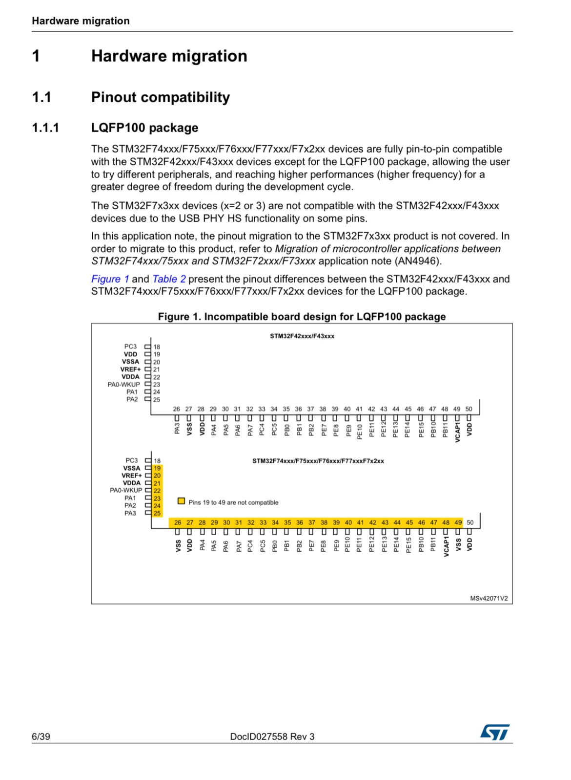

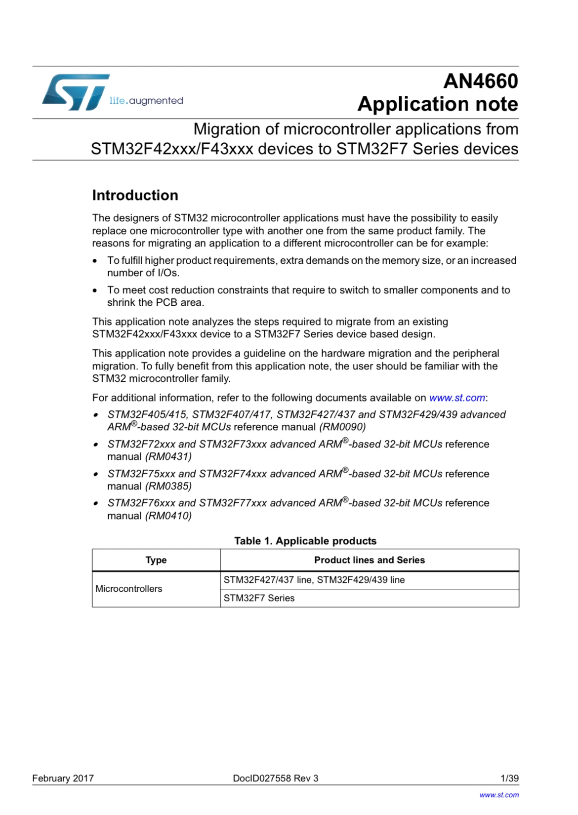

Dear @RhSilicon ,
Indeed LQFP100 is the only package not pin-to-pin compatible with STM32F7 series due to optimized performances and sustain the power rails . Here is attached screenshots from our Application note of Migration
by the way , why moving to F7 or H7 series - curious to know if you need more memories or performance .
