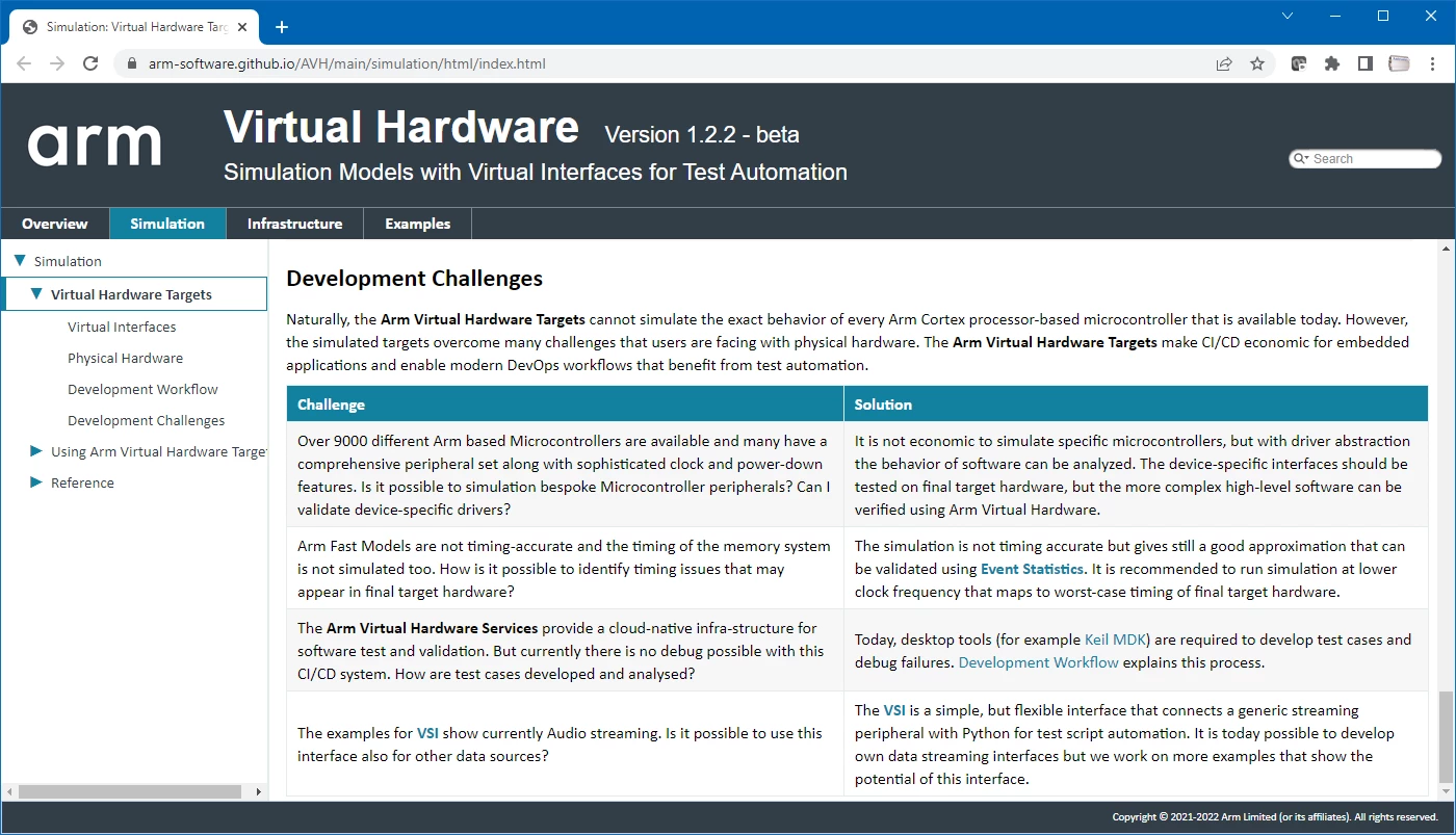

    Pavel A.
    June 6, 2022
    Recently ARM advertised their "virtual hardware". Maybe, this.
    Andrew Neil
    June 6, 2022
    Interesting - although still not a complete, timing-accurate simulation of a specific microcontroller:
    0693W00000NrHlbQAF.pnghttps://arm-software.github.io/AVH/main/simulation/html/index.html#Development_Challanges
