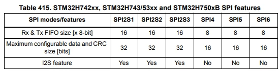

    Amel NASRI
    August 6, 2024
    Hi @rubenles ,
    Based on RM0433, the differences between SPI1 & SPI4 are summarized in this table:
    These differences should be considered at driver level also, so it is important to review the initialization of the SPI instance.
    -Amel
