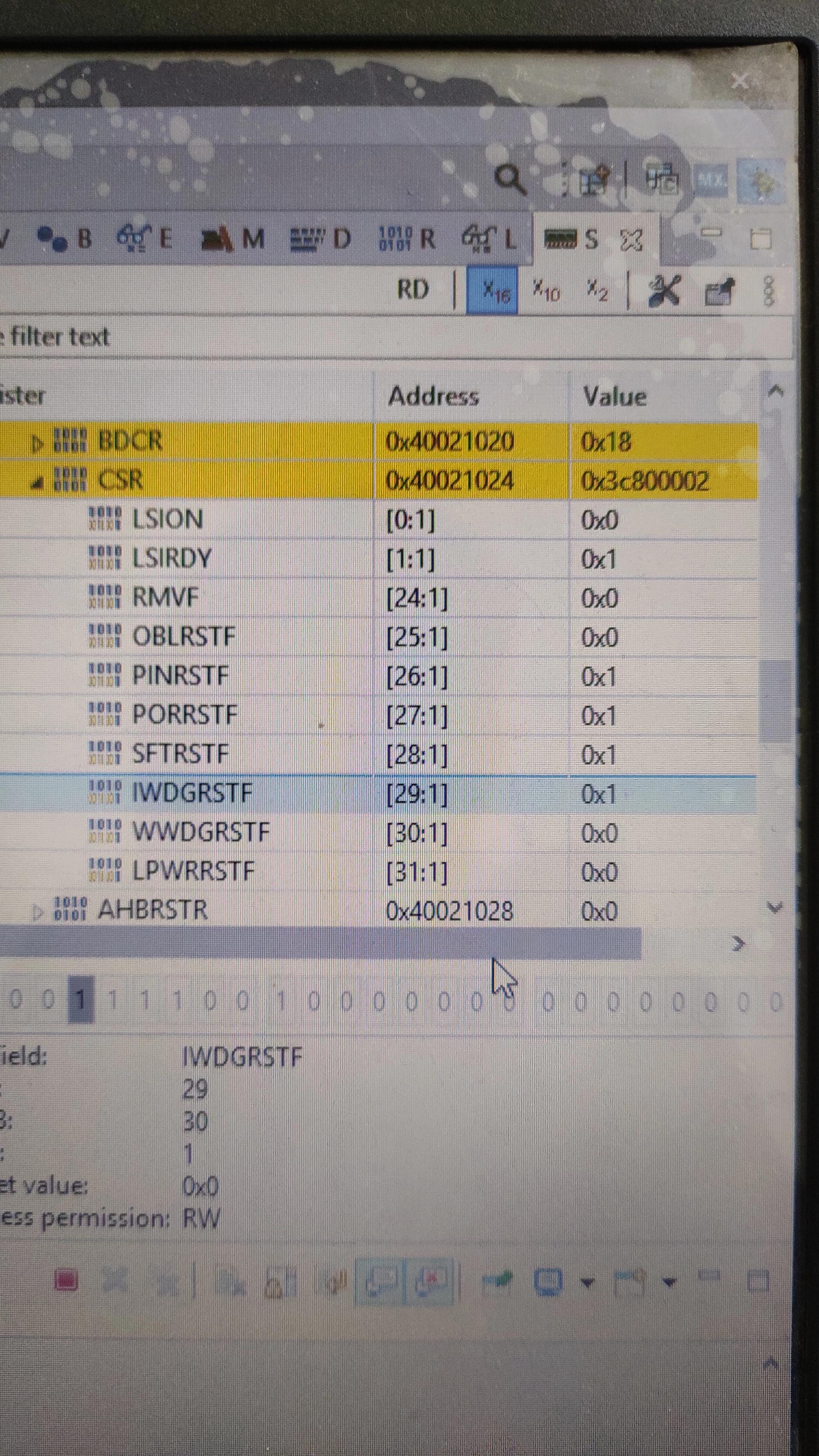

parth kothiya
Jan 7, 2022 2:04 PM UTC
I read rcc_csr before halinit function
It shows internal watchdog timer reset bit set
​I haven't set any watchdog timer in my program.
i preform full chip erase and then i read RCC_CSR it gives same value.
