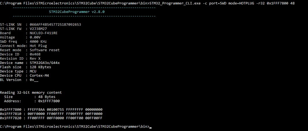

    One more thing off the list. I did use the STM32CubeProgrammer with ST-LINK and read all the Flash Option bytes. The address read is 0x1FFF7800 length 48 bytes. I think this is the correct procedure ...

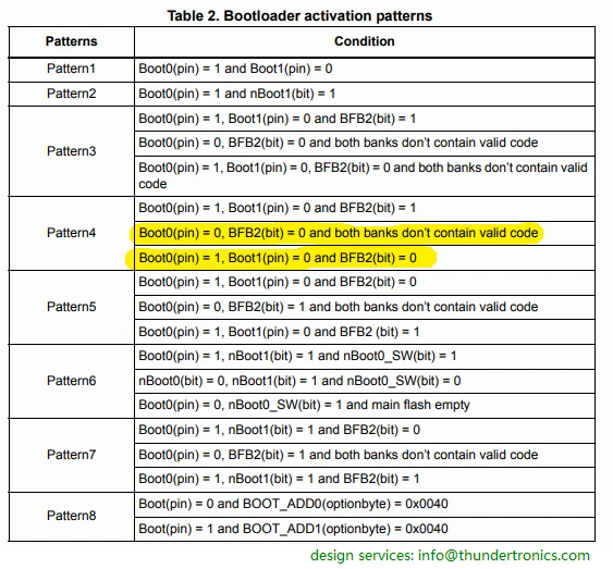

    I've just read AN2606 and "Table 2. Bootloader activation patterns" possibly may explain your problem:
    0693W00000HpaiOQAR.pngUse ST-Link utility and make screenshots of option bytes configuration and each bank beginning address content, compare them. Try to erase chip and reset all option bytes to their default state and repeat 0x7F experiment for both boards. I haven't used BFB2 bit, but as seen from this table you can't get to embedded bootloader in some cases (flash not empty, different option byte values). Probable cause may be that chips was already programmed before (de-soldered chips, pre-programmed chips).

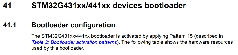

    I will check out the option bytes, but the part I'm using is a STM32G431 which uses pattern 15:

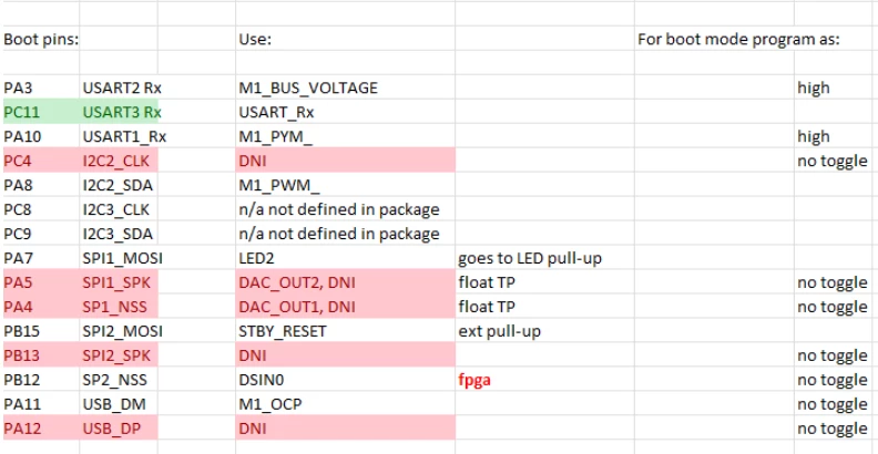

    There are a number of pins used in boot mode that must be dealt with if those modes are not used. The following table lists the pins and their function:
    0693W00000Hqz4pQAB.pngThe USB pin, DNP, on PA12 is a DNI pin and in user code is initialized as a analog with a pull-down. However, in boot mode it is evidently being falsely triggered. Adding a pull-up external to the board allowed the MCU to boot properly into the bootloader. In the list above the right hand column lists 9 pins which must have no toggle or be in a high state to work. This is required in boot loader mode and hence independent of how user code initializes the pins. For now, disabling the user signal dsin0 on PB12 during boot loader mode and adding a pullup on PA12 allows the bootloader to work properly.

    Thanks for sharing this. The "don't touch" pins in bootloader is a tricky issue, and I know of no good detailed analysis of this out there.
