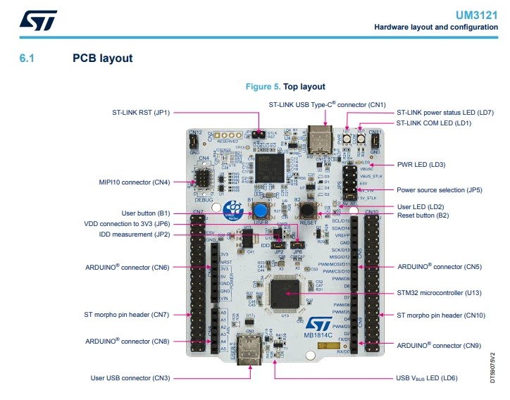

and I just realized it needs ST-link to run and debug my codes. But I thought ST-Link was on board when I checked below link
https://www.st.com/en/evaluation-tools/nucleo-h503rb.html
even i connected board and click debug or run button, it can't find ST-LINK. it said "No ST-LINK detected".
Do I have to buy ST-LINK? Or do I miss something?

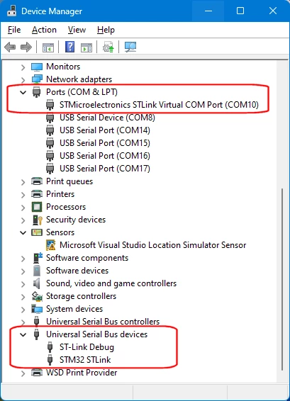

Does it appear in your Device Manager:
Have you tried different physical USB ports?
Are you using a Hub? If so, what happens if you go straight to the computer instead?
Are you sure the cable is good? Have you tried different USB cables?
#VCPDeviceManager
Yes, it is:
Note that there are two USB connectors - are you sure you're using the correct one?

Yes, I've connected the cable to USB STLK which is on the TOP. also I can see the lights from the LD7, LD1, LD2, LD3.
Is there a any drivers that I need to install first?

I finally did it. Somehow one of my USB ports can't recognize this board. but there is no problem with other devices.
Anyway I really appreciate your help.
