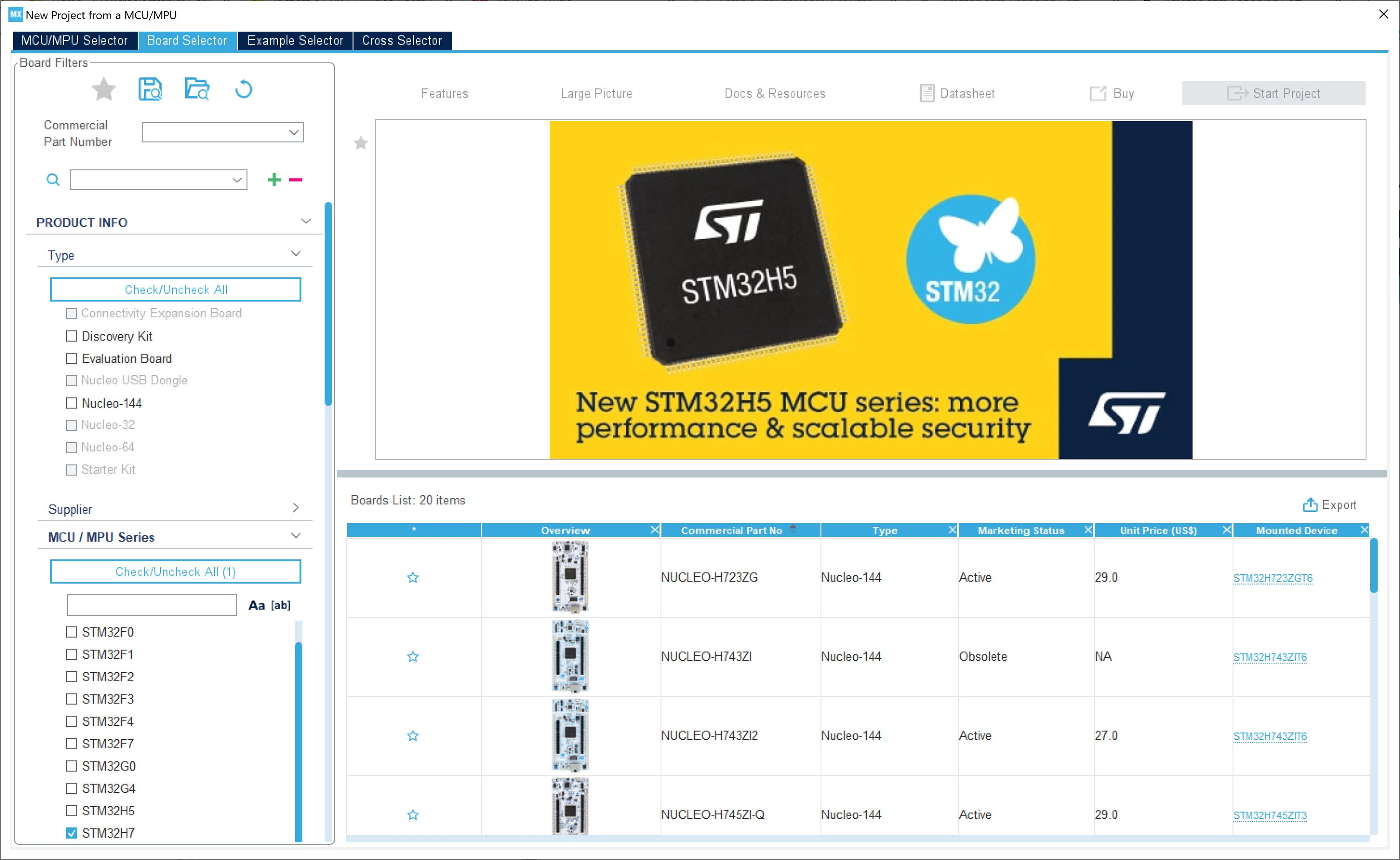

I discovered the STM32 Nucleo development boards and there seem to be lots of models.
After clicking and clicking I can't seem to find the one for the STM32H747XI - TFBGA240+25 Package...
Or at least one with the same number of pinouts... even if in another package.
Most of the ones I saw seem to imply they are fr 144 pin packages...
but the STM32H747XI - TFBGA240+25 Package has 265 pins per the data sheet page 60
Hopefully some kind soul will direct me to the proper STM32 Nucleo board for use with the...
Thanks.

No, there are no nucleo boards for chips with more than 144 pins.
You can see all the ST boards available in CubeMX. Here are the first few for the STM32H7 family:
For the browser issue, the ST site is weird and a bit of a mess, it's not your browser. Some links have changed over the years, some have become private. Expect to find that sort of behavior when digging.
