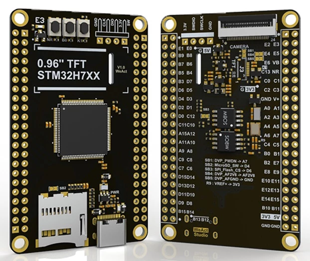

Is there a replacement for the STM32F4 discovery kit?
I am starting a project which involves a CMOS camera. I only need to take still images, not video. I would greatly prefer being able to use a microcontroller over an SBC or FPGA. STMicro used to have an STM32F4 with a camera daughter card, but it appears it has been discontinued.
Is there some similar dev kit at allows the integration of a camera to an MCU?

0693W00000AMwNvQAL.jpgThe WeAct H750/H743 boards are quite economical, have option to buy with a couple of cameras (OV2640, OV7725) and a small OLED display
Can find them on eBay and AliExpress, etc.
https://www.aliexpress.com/item/1005001475058305.html
https://www.aliexpress.com/item/1005001700815862.html
