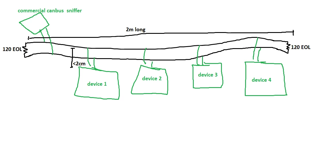

Is the stm system bootloader (trough CANBUS) just not woking when more than one device shares the bus?
Hi, i find myself wanting to use stm bootloader instead of having to code my own.:|
My setup consists in 4 identical nodes hooked up to a 2m long canbus.0693W000007Z6fwQAC.png

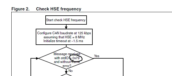

  • I can boot and talk with the canbus bootloader only when a single node is powered on in the bus.(the device enters its bootloader mode and waits for the 0x79 canbus command)0693W000007Z6kIQAS.png
  • Noone else in the bus is TXing anything only listening,
  • BUT ....when more than one node is powered on ... the single node i want to boot doesnt reply to the 0x79 command (and i know is listening because as soon as i power off the rest of nodes and i send 0x79 trough canbus i get a reply from its bootloader)
  • Extra weird thing this only happens with the initial 0x79 command, if i power on the rest of the nodes AFTER this 0x79 negotiation is done i am able to continue talking with the bootloader.
I found this note in the AN3154 appnote
0693W000007Z6nCQAS.pngI dont use more than one node at a time....

from ST support:
Description: Hello, unfortunately the CAN bootloader is designed for use cases where other CAN nodes are not active, which is not suitable for some application. I'm afraid the customer would have to write their own bootloader, or some how temporarily disable the other nodes on the bus. We don't have example for CAN bootloader, but we do for UART: https://www.st.com/content/st_com/en/products/embedded-software/mcu-mpu-embedded-software/stm32-embedded-software/stm32cube-expansion-packages/x-cube-iap-usart.html
So it might be useful for customer as reference.
Best regards, @Adam BERLINGER​
At that point you have little control of the situation, best not to be beholden to the design choices of others..
Can you clamp the unused nodes in reset whilst using the ST system loader? Or gate the transceiver with the BOOT0 or NRST pins?
