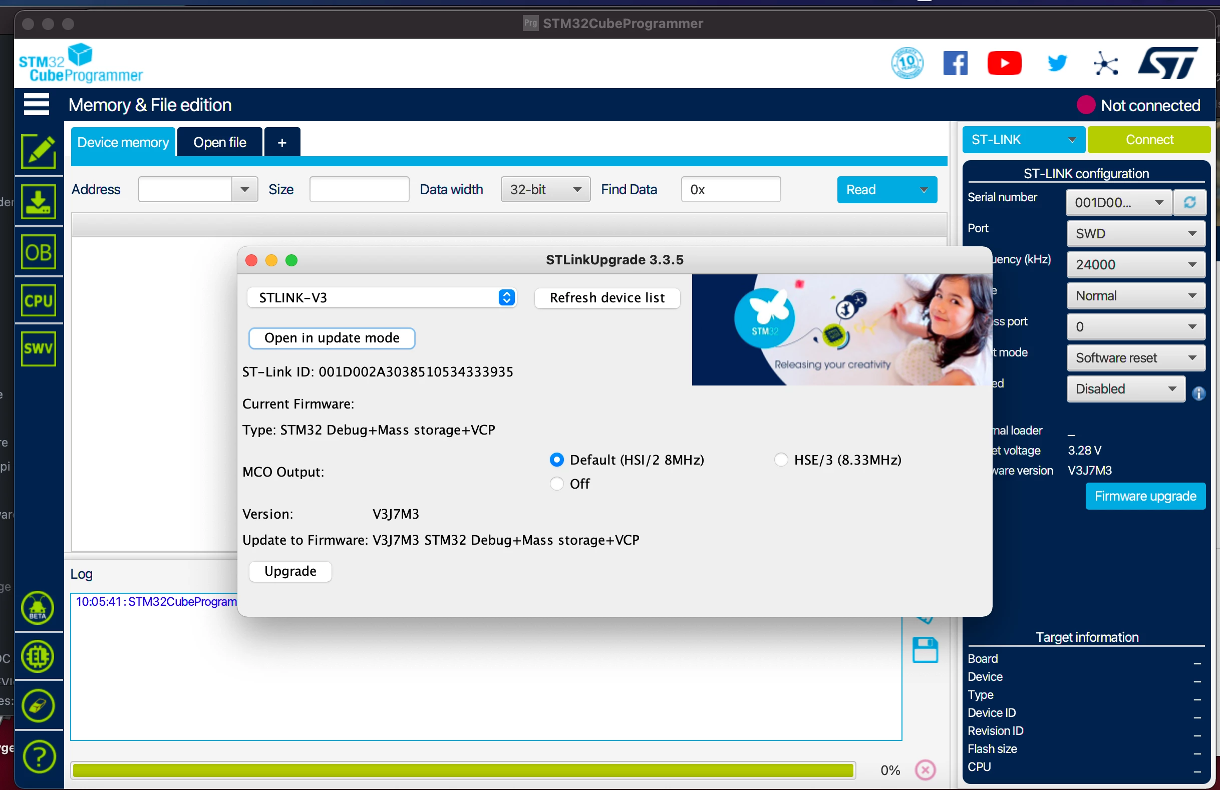

sirius506
May 6, 2021 1:37 AM UTC
FYI.
You can change the ST-LinkV3 MCO config to generate the clock from F723 HSE.
But, resulted clock freq becomes 8.33MHz (sigh...)
