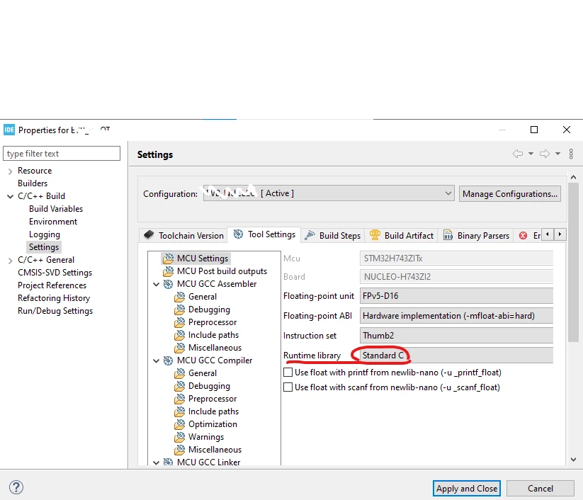

Is sprintf() supposed to support uint64_t numbers?
This compiles with no warnings or errors:
 char buf[256];
uint64_t bignum = 0x123456789;
sprintf(buf,"bignum: 0x%016llx, %llu\r\n",bignum,bignum);
HAL_UART_Transmit_DMA(&huart1,(uint8_t *)buf, strlen(buf));
This comes out the terminal:
bignum: 0x000000000000000lx, lu
%I64d does not compile.

Uwe Bonnes
Chief
Feb 24, 2021 8:26 PM UTC
It depends on the libc used.
KiptonM
KiptonMAuthor
Senior III
Feb 24, 2021 8:41 PM UTC
Thanks
How do I change the libc in STM32CubeIDE?
And which one should I use?
Where can I find the documentation?

Pavel A.
Pavel A.Best answer
Feb 24, 2021 10:13 PM UTC
Select this:
KiptonM
KiptonMAuthor
Senior III
Feb 25, 2021 1:36 AM UTC
I got it!
You have to select the project, then File->Properties. To get to that screen.
Thanks, that fixed it.
