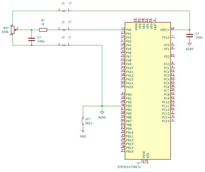

I have just tried this circuit with a Nucleo STM32G474RE board with 100 nF decoupling capacitor and a series resistor that I vary on the input pin:
The preconditions are that I make an AD-conversion every second and with a 170 MHz sysclock and a 42.5 MHz ADC clock. The sample time is set to 12.5 clock cycles or 294 ns. No oversampling.
With the R-resistor set to 0 ohm, I get a peak-peak variation in the result value over one minute of about 33 LSB. When I change the resistor to 6.8 kOhm, the variation drops to about 12 LSB. It is about a 9 dB improvement.
I have also tried values of 3.3 kOhm and 12 kOhm, but then the noise tends to increase. So there seems to be a sweet spot here of this resistor value.

Your wrong.
On these kind of ADC you always need low impedance at input, preferably a cer. cap with 10 or 100 nF direct to ground.
If you want to know why, read about "charge redistribution ADC" , then you should understand.
The maximum impedance depends on sampling time and there is a table with values in the RM.
And have very short wire to the cap or impedance buffer amp, as on high resolution ADC you get many millivolts RF even on 50mm wire to ground.

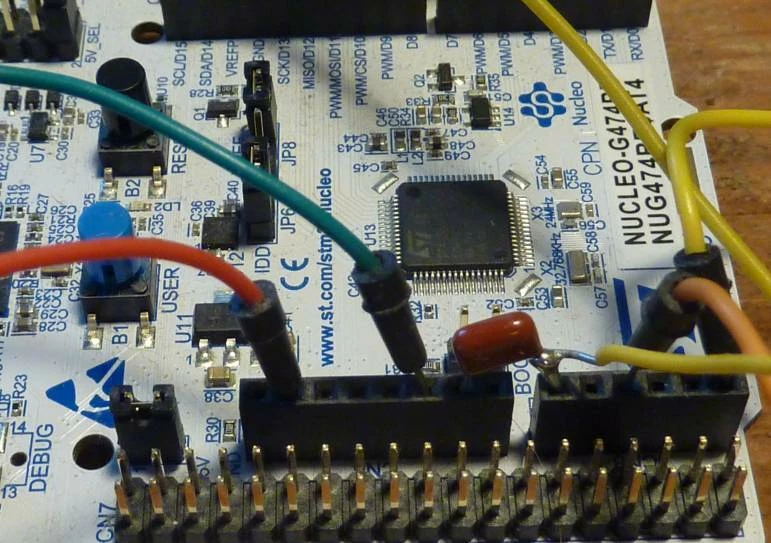

I think you are right and I was wrong. I repeated the test with the 100 nF decoupling brown capacitor closer to the PCB as you see here. But I use the normal power GND here, because it is closer.
This reduced the measured noise to about 3 LSB peak-peak. The same schematic with about 100 mm long wires to the decoupling capacitor resulted in 33 LSB peak-peak as reported before. Apparently the possible inductive loop here could pick up a significant amount of noise. I know this position of the capacitor is still not perfect, and could be made better when you make a PCB design.

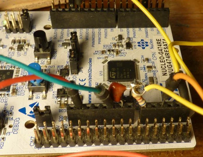

I did also try to add the resistor in this situation like this:
This resulted in higher noise values and about 10 LSB peak-peak.
So now I am sorry to have made this post, but at least it can illustrate that such external wiring can pick up significant noise.

  1. “AGND” should be connected to the common GND plane, as low impedance as possible. It would be nice to have the VDDA buffering cap(s) directly at the VDDA & AGND pins, but with the many ADC inputs all over the package, there’s no use connecting the ADC input RCs to AGND. Just make sure that the ADC input RCs are as close to the ADC input pin as possible, without any noisy digital IO adjacent - if possible.
  2. The Nucleos… great & inexpensive tools, but the PCB layout was made for many different uses, not much for the ADC inputs. There are some terribly long tracks running all around the board, due to solder bridge and connector options.
So with better placement and layout, signal quality will probably reach the number of bits as advertised, but also depending on the sampling rate.
And as Jan said, in case of doubt a big cap might not be good enough, so a driver op- / dif-amp and using differential inputs might be required.
