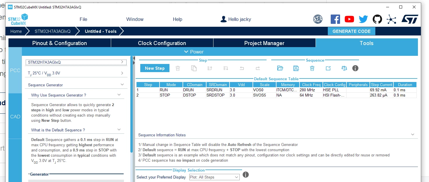

JBURB
September 22, 2023
the strategy to use low power mode can be tricky. Perhaps to find the appropriate configuration, you could use the tool provided by CubeMX: PCC. You can define a sequence of run/sleep/stop/standby and get an average current:
Br,
Jacky
