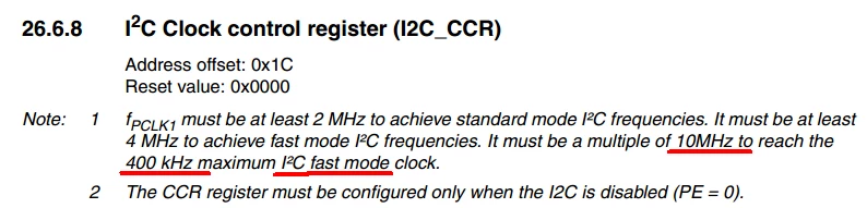

    In reference manual RM0008 they had written, for i2c fast mode operation i2c clock frequency must be a multiple of 10MHz. To achieve this I had set SYSCLK 40MHz (HSE: 8MHz and PLL :5). Configured Duty bit as 1(in I2C_CCR register,Actually I didn't understand yet the purpose of duty bit. I have attached the images from RM0008) . I had tested with this configuration and I was able to get fast mode I2C frequency(400KHz ).

    to make USB working. By changing sysclk to 72MHz I2C clock becomes 36MHz(not a multiple of 10MHz). Using this clock configuration I tested I2C fast mode again. But now my I2C clock frequency changed from 400KHz to 480KHz(Data transfer is working normal) . But my requirement is 400KHz . I want use USB also.....
    I believe that u are able to understand my problem now... Is there any solution for this....?
    I tested with 48MHz sysclk and I couldn't acquire 400KHz
    My requirement is I2C fast mode(400KHz) + USB full speed

    I changed the crystal many times, there is no solution for 48MHz USB and x10MHz IIC
