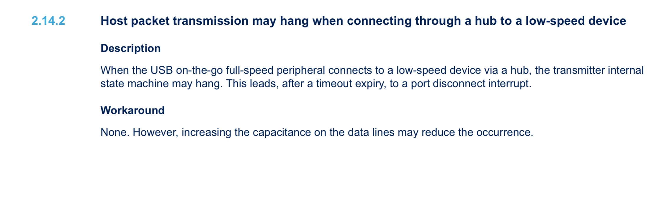

Is it possible to use USB HUB with STM32F4 using external PHY?
Hi, I found a post by Renesas, about using Azure rtos, where it is possible to use the HUB class for USB Host.
Can any problem already known to the internal PHY also occur in the external PHY? Is the external PHY able to be used with USB HUB?

Dear @RhSilicon ,
we have many customers using STM32F4 as USB host and connecting a HUB using partners Hub class, the only known limitation at the internal PHY Full speed is to not connect a Low speed device as specified in the silicon errata here .
However if an external ULPI PHY is used for High and full  speed it is working fine.

Won't increasing the capacitance of the data lines stress the silicon chip? How much is the value of the capacitor to be added in each line?
