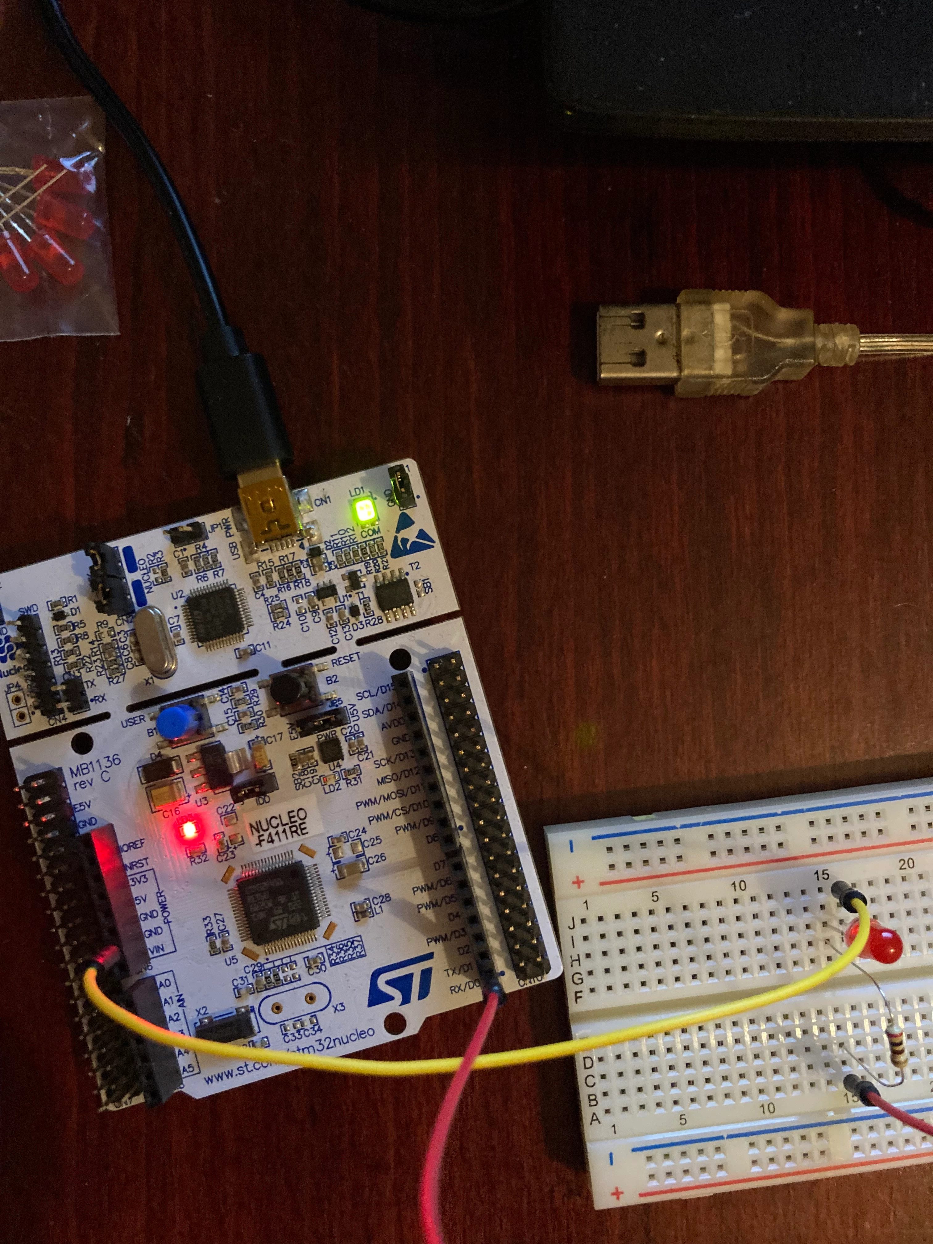

Is it possible to use USART RX/TX legs to blink a led?
Hello!
I have an STM32F411RE nucleoboard.
I tried to use PA2 (TX) and PA3 (RX) as a general output. I enabled the clock access and also setted the mode register to general purpose output mode, but when I connect the LED and set the pin high nothing happens. If I connect it to another pins e.g. PA0 (A0), PA1 (A1), PA8 (D7) it works fine. Could it be because the RX/TX legs can't be used as a general purpose output?
Thanks in advance for the help!
Best regards,
    Mike_ST
    Mike_STBest answer
    Nov 18, 2021 4:00 PM UTC
    As I said before don't forget to close SB62 and SB63 too, just a bit of tin between the pads will do the job.

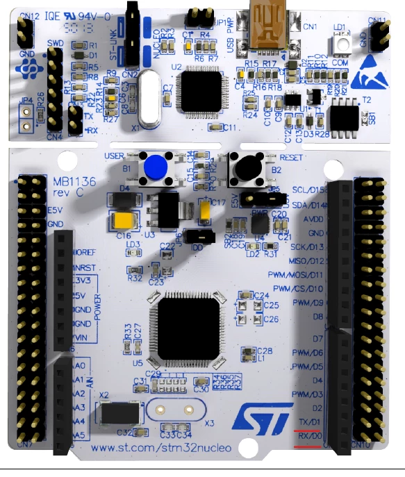

    Mike_ST
    Nov 18, 2021 10:18 AM UTC
    PA2/PA3 can be used as GPIO, but you have to remove SB14 and SB13 to disconnect them from the ST-Link UART interface.
     + check that SB62 and SB63 are set.

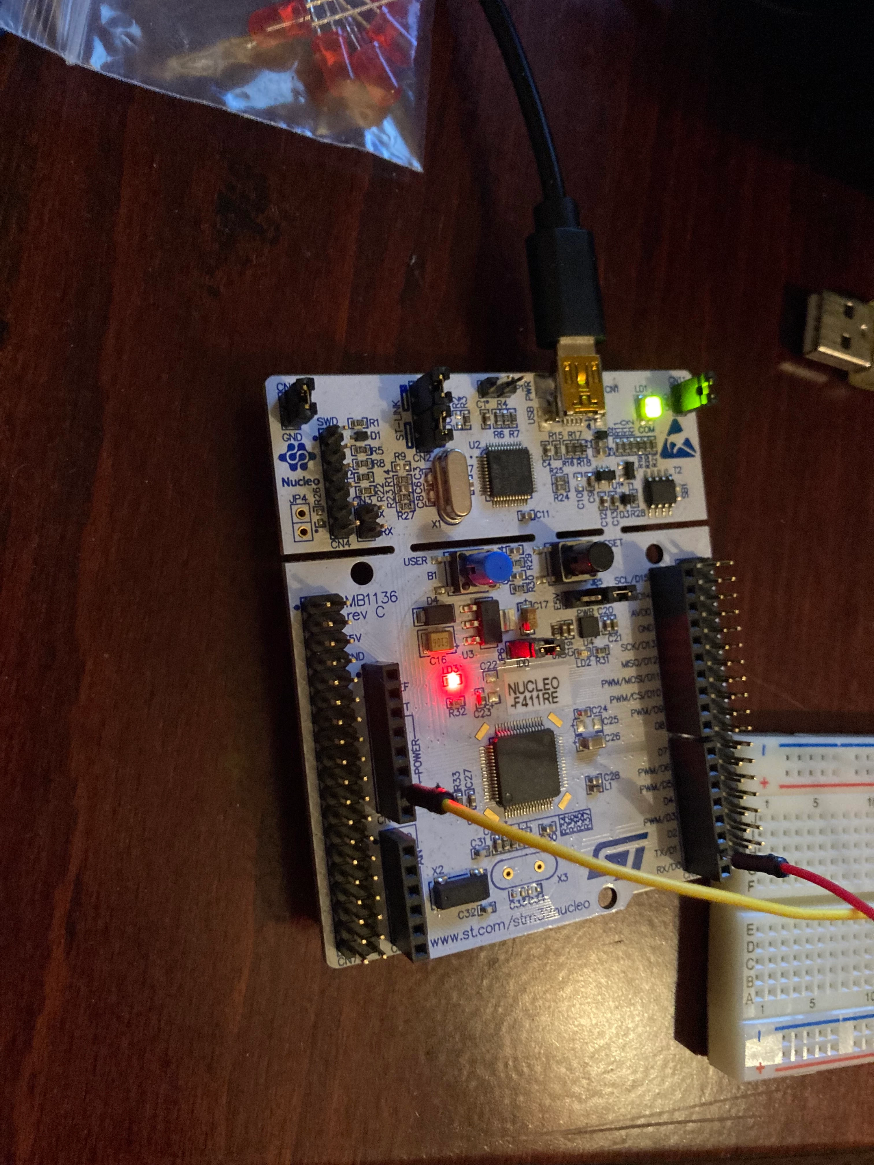

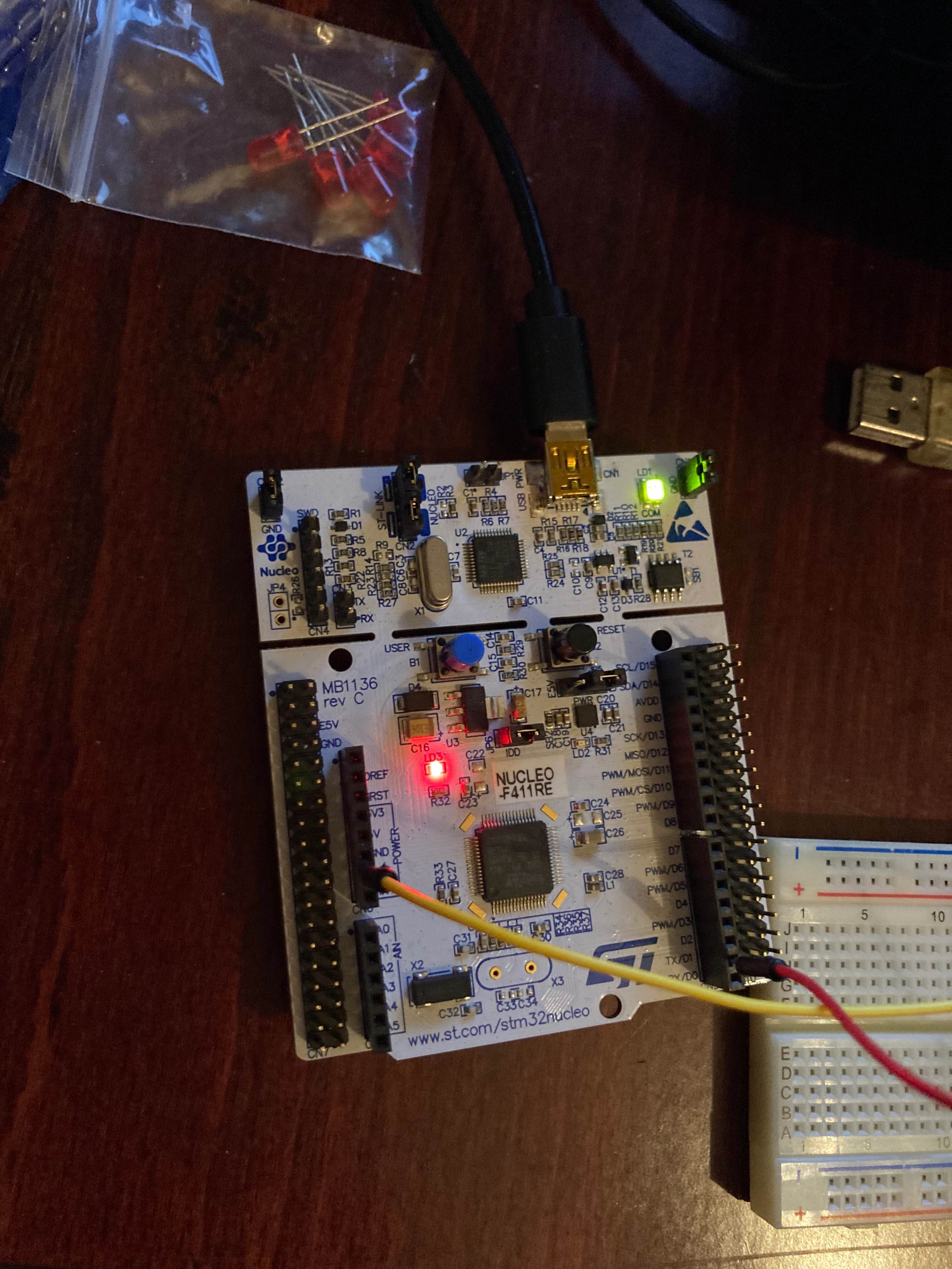

    MSzal.1
    MSzal.1Author
    Nov 18, 2021 3:20 PM UTC
    Sorry for this dumb question. Could You show me on the pictures which solder bridge should I remove? I checked the datasheet and I found SB13 and SB14 but I can't see where it joins. I attached 3 pictures about the board.
    Thank You! :)0693W00000GY3oLQAT.jpg0693W00000GY3o6QAD.jpg0693W00000GY3ofQAD.jpg
    Mike_ST
    Nov 18, 2021 3:32 PM UTC
    I can't show you with your pictures, because it is on the other side of the board.
    In UM1724 page 14 Figure 4 "Bottom layout", they are shown.
    https://www.st.com/resource/en/user_manual/um1724-stm32-nucleo64-boards-mb1136-stmicroelectronics.pdf
