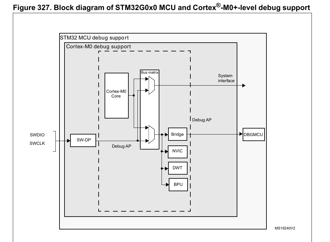

is it possible to use the ITM on the stm32g051
Is it possible to use the ITM or to get debug message from the stm32g051 using the PEmicro multilink universal?
I try to insert this code but aparently there is no CoreDebug on the stm32g051g8.
Thank you.
2 replies
AScha.3
March 21, 2025
From rm cortex M0+ :
Here is no ITM.
