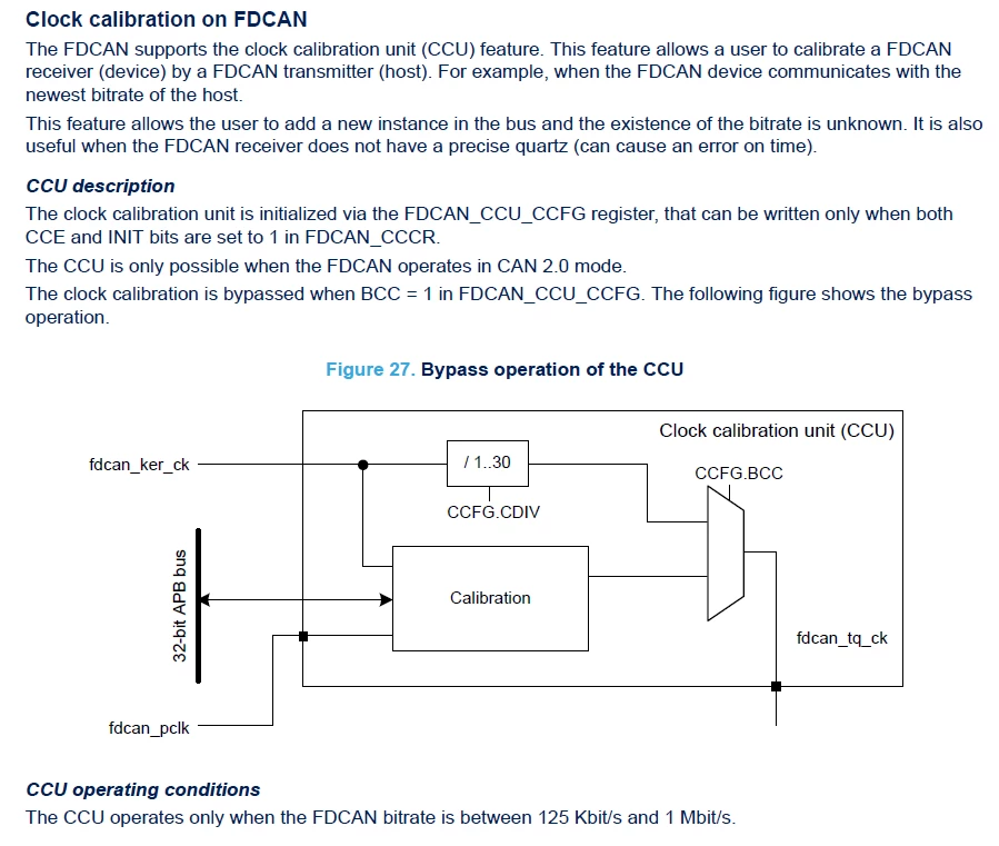

Is it possible to use the FDCAN Clock calibration Unit (CCU) to do an automatic baud rate detection of the arbitration phase.
I have to connect my STM32H7 board to a network with unkown parameters. Is it possible to use the FDCAN Clock calibration Unit (CCU) to do an automatic baud rate detection of the arbitration phase.
1 reply
Visitor II
July 2, 2024
Have you found a solution?
Could you use Clock Calibration for this?
