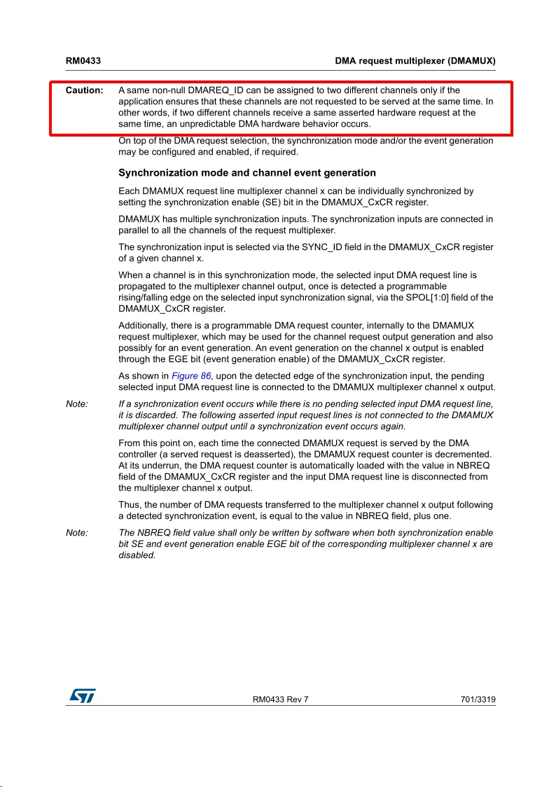

Is it possible to update more than 1 DMA stream on a "timer up" DMA request (TIMx_UP)?
I am using an STM32H7B0 with the HAL library and can initialize and start the timer/dma interrupt for one DMA request but can more be introduced for the TIMx_UP interrupt?
DMA_HandleTypeDef hdma_timx_up;
hdma_timx_up.Instance = DMAx_Streamx.
HAL_DMA_Init(&hdma_timx_up)
start (for GPIO toggling)
HAL_DMA_Start_IT(htimx.hdma[TIM_DMA_ID_UPDATE], (uint32_t) dmaarray, (uint32_t) &(GPIOx->BSRR), dmalen);

No.
The underlying reason is, that for some peripherals - including TIM - the DMA request goes through a latch, which is reset by the DMA/DMAMUX when the request is served. In other words, the first channel which serves the given request clears the latch, with unpredictable results to the second channel connected to the same request. In 'F4, this leads to one of the DMA streams to be frozen entirely (guess how do I know :) ); with DMAMUX the results may be different, but the above warning in the RM indicates, that this is simply something which is not to be attempted.

waclawek.jan
May 22, 2023
That just means, that you can use any DMAMUX channel for any request, not that you can use several DMAMUX channels at the same time for the same request. See the RM screenshot I gave above.
