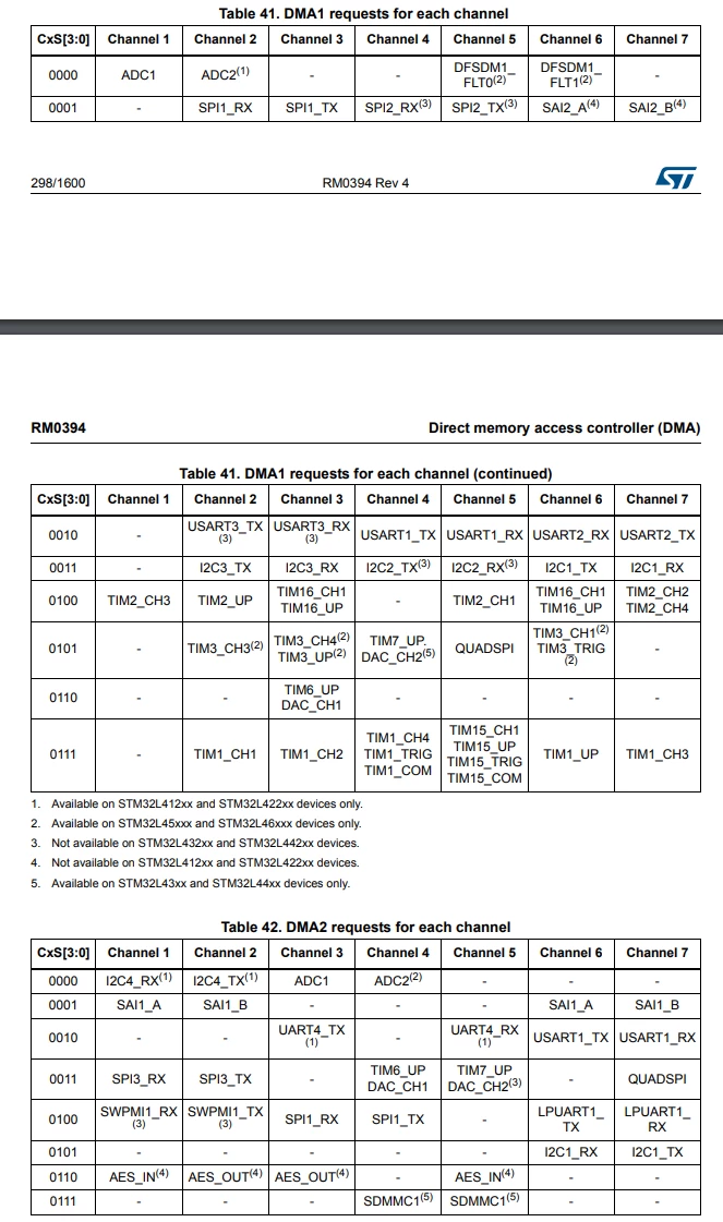

is it possible to transfer data through CAN using DMA, Does the CAN support DMA?
I want to receive the data from one nucleo board through CAN protocol and it should trigger the DMA and shuffle the received data and transmit back again to another board.
In ioc configuration I am unable to enable the DMA (peripheral to memory and vice versa), it is showing like Memory-to-memory configuration. Manually I added the DMA configuration and trying to link the DMA with CAN peripheral, it is showing error like CAN_HandleTypeDef has no member named 'hdmatx'

Ok thanks:
If you look at the reference manual RM0394 tables 41/42, there is no DMA request to the CAN peripheral:
So no CAN transfers with DMA.

First answer: not possible to use DMA with CAN.
Which product are you using?

I am using Nucleo-L452RE board.

The Reference Manual(s) for the chip(s) you are using will tell you what peripherals are capable of DMA.
The Reference Manual will be available on the Product Page for the chip, under 'Documentation'.
You haven't said what chip(s) you are using, so impossible to be more specific.

Before closing the thread could you please provide the MCU part number or the board you're using?
The answer I provided needs to be more cocurate if you provide this info.

MCU part number is 497-17008-ND

That's not an ST Part Number!
As already noted, the ST Part Number for the MCU chip is STM32L452RE
(It looks like a DigiKey stock number - for the board, not the MCU)
