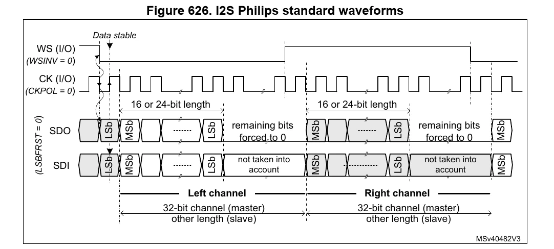

@Community member​ - "The one-clock delay of data " - i never understood, because clocking in or out data , slave or master, needs no extra delays. so why Philips did this? because need some obvious difference to "normal" (= no curious bit delays) ?
here the standard I2S timing:
0693W00000UoAcUQAV.pngall bits in frame :
waclawek.jan
October 17, 2022
It allows the slave transmitter to perform a clean initialization sequence:
  • wait until WS right-to-left (downgoing) edge
  • now you have roughly one bit time to perform whatever you need to do internally to load the first word into the shift register
  • wait for the CK sampling (upgoing) edge
  • enable CK to shift register, so that upon next CK shift (downgoing) edge the first data bit is shifted out
With the MSB timing, you would need to have the first data ready beforehand; and also output its first bit upon WS transition rather than upon CK transition, which means the first data bit may have different duration due to potential clock skews and internal logic delays (the WS logic is "heavier" than the CK logic). The difference is entirely negligible nowadays, but (cheap commercial) logic was way slower back then.

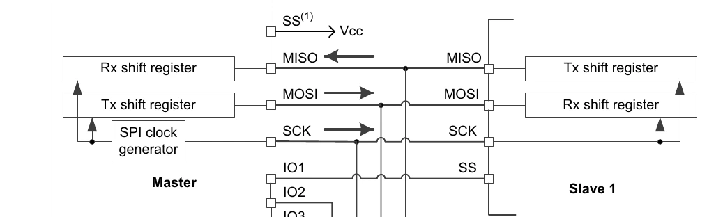

> just look at SDI/SDO swap in slave mode vs master mode.
Hadn't noticed that thanks. But datasheet must be wrong in one place or another
55.9.2 :
• SDO: Serial Data Output (mapped on the MOSI pin) to transmit the audio samples in
master, and to receive the audio sample in slave. Refer to Section : Serial Data Line
swapping on page 2129.
• SDI: Serial Data Input (mapped on the MISO pin) to receive the audio samples in
master, and to transmit the audio sample in slave. Refer to Section : Serial Data Line
Goto page 2129 and the information isn't the same :
Serial Data Line swapping
The SPI/I2S offers the possibility to swap the function of SDI and SDO lines thanks to
IOSWP bit located into SPI configuration register 2 (SPI_CFG2). Table 406 gives details on
this feature.
Table 406. Serial data line swapping
This show the input for Master & slave RX to be on SDIN unless you set IOSWP = 1. But says IOSWP = 0 is default.
Any idea which is correct ?
AScha.3
October 17, 2022
i had this problem and cost me some hours... on STM32H743 :
when switch master -> slave transmitter , SDO becomes SDI !
so need swap ( set =1) to get data on same pin as before in master mode.
see here , same pin (MOSI) is connected to in or out , depending on master/slave setting !
0693W00000UoCJPQA3.pngi tell my problem here:
 https://community.st.com/s/feed/0D53W00001oJqe3SAC
