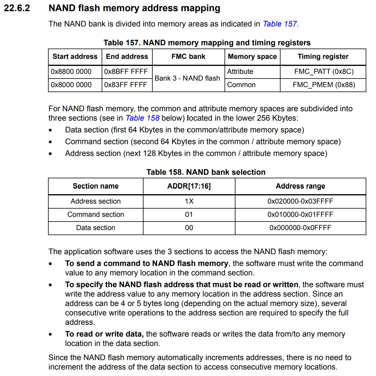

Is it possible to read NAND memory using a pointer remap without the HAL_NAND_Read_Page_8b functions
Hello everybody!
I am using an STM32H750VBT6 controller and a NAND memory - MX30LF1G18AC. Initialization via CubeMX, using the development of a Keil.
I can view the id, I can record and view all the entries: HAL_NAND_Write_Page_8b, HAL_NAND_Read_Page_8b

I need to work with this memory directly through the pointer.
like for example:
#define NAND_R(adr) *(uint8_t volatile *) (0x80000000 + (adr))
uint8_t buf[128];
for (uint8_t i = 0; i < 128; i++)
buf[i] = NAND_R(i);
Is this possible?

NAND typically infers block addressable memory, not byte addressable.
It fetches a requested block from a large array, and you FIFO out the block as a whole. Other out-of-band data is used to provide error-correction code space for the data portion, allowing it to fix bits which get corrupted or read as an undefined/undetermined value. The memory has very few address bits, the address being used to identify command vs data interactions.
Good for mass-storage applications, not for random read-writes or code execution.
2 replies
February 2, 2024
No, this won't work.
See the reference manual for how NAND memory must be accessed. You need to specify a page to access before you access that page.
