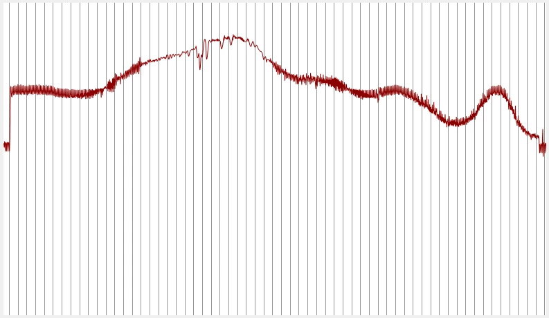

Hi everyone
I have a system that uses a STM32F205 to sample on a signal at 2MHz. I wanna generate a signal that indicates the sampling times of the ADC as im battling with some frequency differences in my system. Interrupts are sadly not an option as it is used for the data acquisition and external communication. DMA requests from the main ADC isnt an option either as it is being used to aquire data and AFAIK it isnt possible to generate seperate DMA requests from a single peripherial.
My current plan and what i have been working on is setting up an identical ADC that doesnt save the sampled data but instead uses its DMA request to initiate a double buffer DMA transfer to a GPIO register. This would ideally generate a signal that switches at each sample.
My questions are:
  • Is my method even possible?
    • I havent seen any reason for it not to be but it seems like a unorthodox DMA setup so im not sure.
  • Is there a better mothod for generating this test signal

MStee.1
MStee.1Author
August 3, 2021
0693W00000D1Pv6QAF.pngI dont doubt them per say but i doubt my implementation of them.
As seen in the attached picture i get noise at the ends of my signal but not in the middle. This is despite the measured noise being uniform switching noise that persists throughout the signal. My current hypothesis is therefore that the ADC and the Timers are running at slightly different frequencies as this pattern persists over multiple measurements. Ive also checked the generated timer signals and they run consistantly at the specified frequencies with very low deviation.
This is why i wanted to generate a signal that indicates the start of each ADC sample to visualize and possibly solve the problem.
August 3, 2021
Ah, understood.
I don't think there's a way of doing this. Not sure what else could help other than general advice on minimizing ADC noise.
https://www.st.com/resource/en/application_note/cd00211314-how-to-get-the-best-adc-accuracy-in-stm32-microcontrollers-stmicroelectronics.pdf
