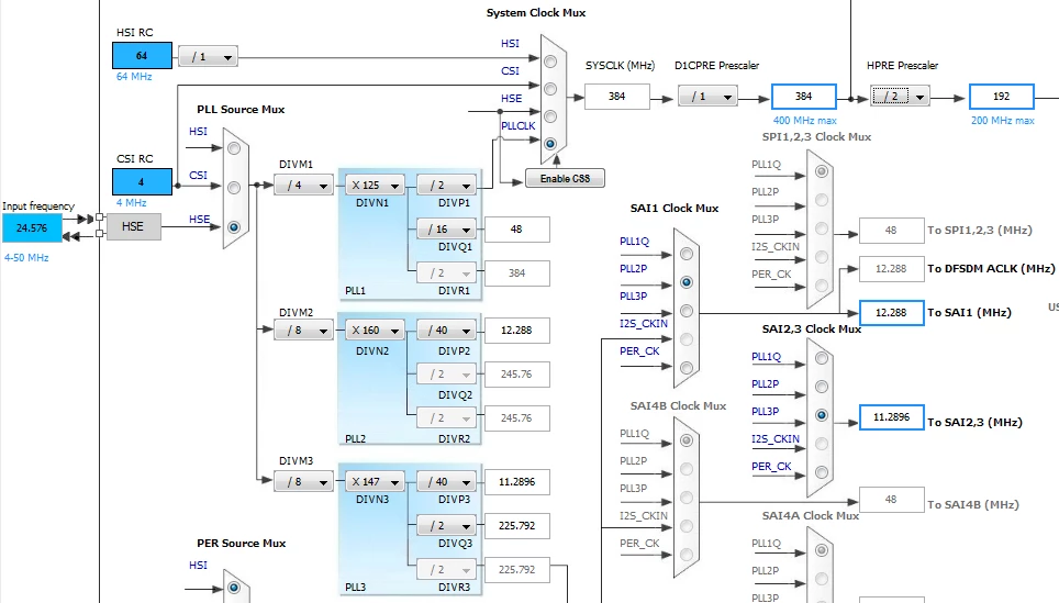

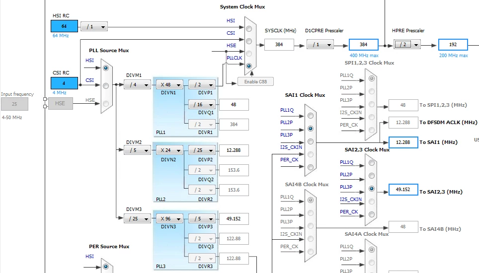

Piranha
Principal III
Mar 25, 2019 8:05 PM UTC
That is how one can get all 44,1/48 kHz based exact audio clocks and 48 MHz for USB simultaneously from a single 24.576 or 12.288 MHz crystal. Actually only one PLL for audio clock is needed if re-configuring DIVN. And by changing DIVP a x2, x4, x8 clocks can be obtained. That would be the most typical way of doing this.
And now about original question. Here we go:
