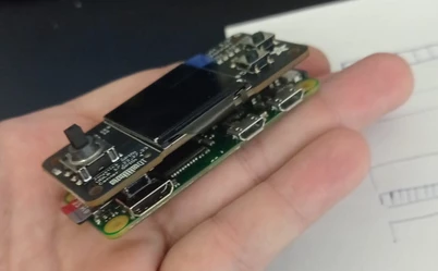

Small battery powered blob that ,when plugged to the electronics ,flashes things automatically.
im doing a similar product for a client.
Im just giving them a battery powered raspberry Zero with a stlink connected to its USB. (openocd)
with a fancy screen so they know if everything went ok
the raspberry is running python/bash scripts to detect and flash new chips automatically (plug and flash)
 And, if connected to wifi, checks github for firmware updates
With minor modifications this can be archieved with any device running linux

That's not something that I've thought of, although a raspberry pi zero in a case with a screen is more hardware than I wanted to deal with. In my experience a SPI controlled screen for a raspbery pi is usually about 320x240 in resolution and so the OS and touch functionality for navigating is almost useless. Could you perhaps share a link to the screen hardware if possible?
Javier1
Principal
November 3, 2021
At the moment my client just needs to plug the thing and flashes automatically, no need to have touch functionality nor OS navigation.
(i could access trough ssh if needed)
The screen just gives a very rudimentary one direction GUI, it feels alive and expensive that way.
You could also get away with a small piezo that goes BEEEEP or BEP BEP.
