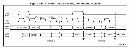

Is HARDWARE NSS PULSE possible for SPI_TIMODE or MOTOROLA MODE master connected with a single slave device using DMA in STM32F407VG

There is a vague indication using timing diagram that NSS pulse output will be controlled by the SPI driver in TI Master mode
[Figure 252 pg no 884 .Reference manual
STM32F405/415, STM32F407/417, STM32F427/437 and
STM32F429/439 advanced Arm®-based 32-bit MCUs]
My SPI peripheral needs a NSS high pulse for Indicating end of frame.
Is there anything i should look into to enable NSS pulse mode so that i can use a DMA where the SPI driver triggers a NSS Pulse by itself between each frames

No, "NSS pulse" is available only in newer STM32 models.
As a workaround, you can use a timer to generate the NSS pulse, and use that time to trigger DMA instead of SPI Tx to load the SPI_DR.
