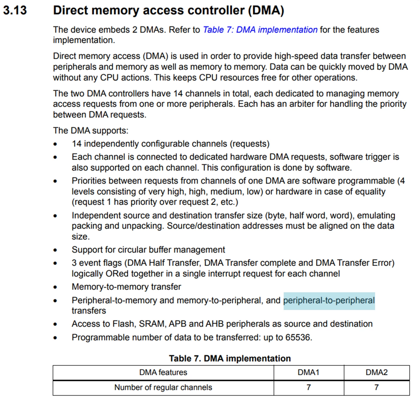

I am currently working on a project that requires pushing data directly from a uart rx pin directly to an SPI device (an external SRAM) tx pin
One way to do it, is by using DMA , unfortunately most Stm32 MCUs do not offer a peripheral to peripheral dma mode.
but it is mentioned in the datasheet of the L476rg MCU that it offers a peripheral to peripheral dma mode however when attempting to set up DMA data transfer mode as peripheral to peripheral in CubeMX (whether for the SPI or the UART) it is not found
So is there a way to do it ? is it even possible ? and if not is there any other way ?
Please note that the spi device is an external SRAM so i am trying to minimize internal memory usage as possible.

Seems like you would just set it up as a peripheral-to-memory transfer:
DIR = 0 defines typically a peripheral-to-memory transfer. More generally, if DIR = 0:
– The source attributes are defined by the DMA_PARx register, the PSIZE[1:0] field
and PINC bit of the DMA_CCRx register.
Regardless of their usual naming, these ‘peripheral’ register, field and bit are used
to define the source memory in memory-to-memory mode
– The destination attributes are defined by the DMA_MARx register, the
MSIZE[1:0] field and MINC bit of the DMA_CCRx register.
Regardless of their usual naming, these ‘memory’ register, field and bit are used to
define the destination peripheral in peripheral-to-peripheral mode.
