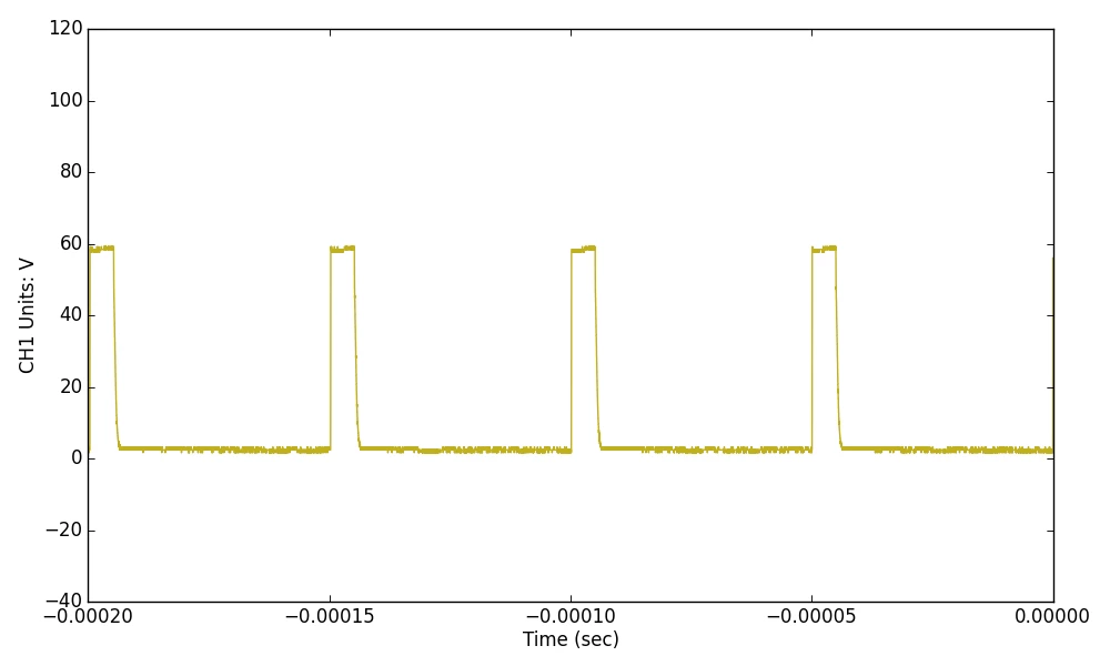

MKunz.1
MKunz.1Author
Nov 25, 2020 7:40 AM UTC
Two Scope screen shots.
