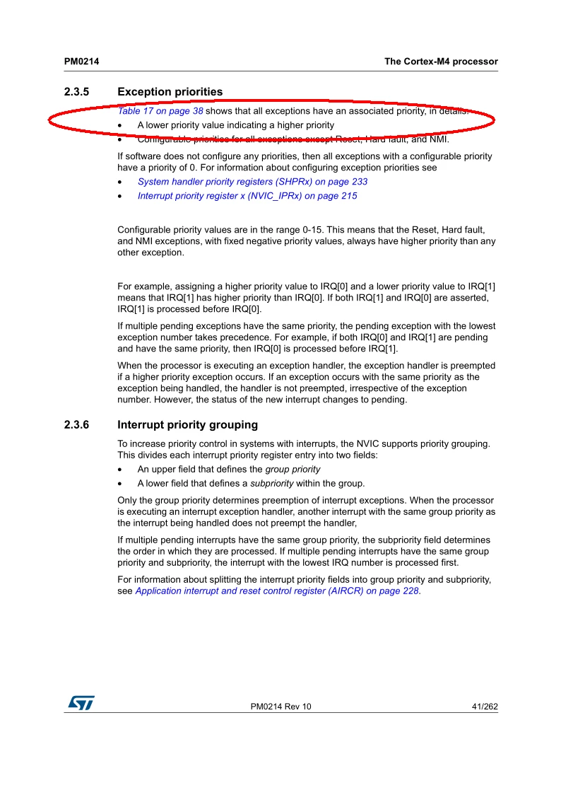

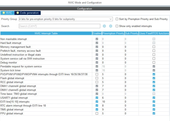

Is 0 lowest or highest priority?
Hi, its not clear for me, does lower number represent higher or lower priority?
Is "System tick timer" at highest or lowest priority?
    waclawek.jan
    waclawek.janBest answer
    August 23, 2021
    0693W00000Dq4coQAB.pngJW
    1 reply
    waclawek.jan
    August 23, 2021
