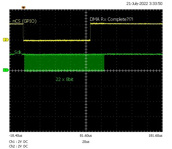

I use an SPI interface with Rx and Tx DMA to transfer a 22 byte buffer from a spi slave. Chip select is handeled with
LL_GPIO_ResetOutputPin(TDK_nCS_Port, TDK_nCS_Pin);
set to high again to end transfer I wanted to use:
// SPI5 - IMU TDK Rx
void DMA2_Stream3_IRQHandler(void) {
if (LL_DMA_IsActiveFlag_TC3(DMA2)) {
LL_DMA_ClearFlag_TC3(DMA2);
Imu_Icm42688_DMA_RxCompl();
} else if (LL_DMA_IsActiveFlag_TE3(DMA2)) {
LL_DMA_ClearFlag_TE3(DMA2);
Imu_Icm42688_DMA_Error();
I can accept that using TxComplete is not working as it fires when last byte is written to interface buffer (therefore not yet sent). But why on earth can the RxComplete IRQ fire too early. See image below for..

What chip? Using FIFO?
hth
KnarfB
waclawek.jan
July 21, 2022
Which STM32?​
> 22x8bit
Did you​ count them?
Do you use simplex or bidir mode?​

Thx for your time.
I use the stm32f767. Both DMA are in heavy use (UART, SPI, SD-Card).
I do not use double buffer if that is meant by FIFO.
Yes I actually counted all the 22x8 clock pulses just to be sure since I really could not make any sense out of it.
I stuck pretty close to the ST example for SPI DMA full duplex out of the current F7-examples.
// RX DMA Stream
LL_DMA_ConfigTransfer(DMA2, LL_DMA_STREAM_3,
LL_DMA_DIRECTION_PERIPH_TO_MEMORY | LL_DMA_PRIORITY_MEDIUM | LL_DMA_DOUBLEBUFFER_MODE_DISABLE | LL_DMA_MODE_NORMAL |
LL_DMA_PERIPH_NOINCREMENT | LL_DMA_MEMORY_INCREMENT |
LL_DMA_PDATAALIGN_BYTE | LL_DMA_MDATAALIGN_BYTE);
LL_DMA_ConfigAddresses(DMA2, LL_DMA_STREAM_3, LL_SPI_DMA_GetRegAddr(SPI5), (uint32_t) imu_icm42688_rx_buffer.raw, LL_DMA_DIRECTION_PERIPH_TO_MEMORY);
LL_DMA_SetDataLength(DMA2, LL_DMA_STREAM_3, 22);
LL_DMA_SetChannelSelection(DMA2, LL_DMA_STREAM_3, LL_DMA_CHANNEL_2);

I have the same issue on STM32G0. Did you find a solution yet?
snigg
sniggAuthor
November 15, 2022
In my case it was "data" in the double registered SPI buffer. I had to ensure Rx-Buffer is completely empty either by dummy data read or read the state (count) of current data.
gbm
November 15, 2022
(Deleted wrong answer) The problem might be related to the famous FRXTH bit setting.
