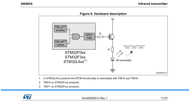

The following circuit was pointed out on a local electronics forum:
I mean, it *may* work, under certain circumstances... nonsense nevertheless.
One of the comments was, that it nicely complements Cube... ;)
