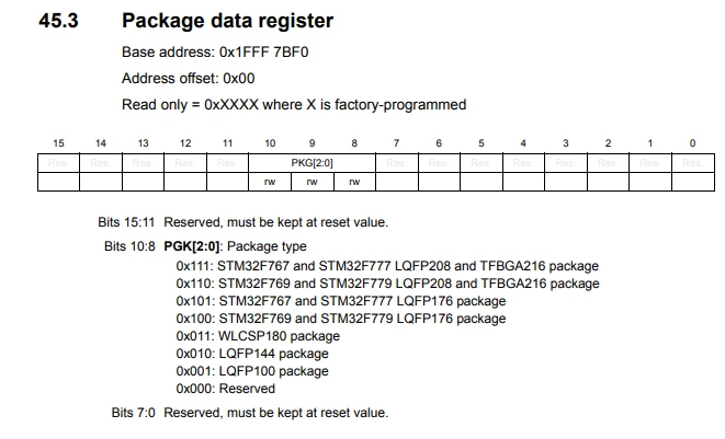

I am trying to read the package type on a STM32F767Zi Nucleo board and instead of getting the correct value of 0x010, I am getting 0x111.
Can you please tell me what is the problem?
Is the register address wrong?
Is the table of values wrong?
I have tried this in 2 Nucleo F767Zi boards reducing the probability that it is board specific.
I noticed that another ST user has noticed something similar.
Thank you very much for your time.
