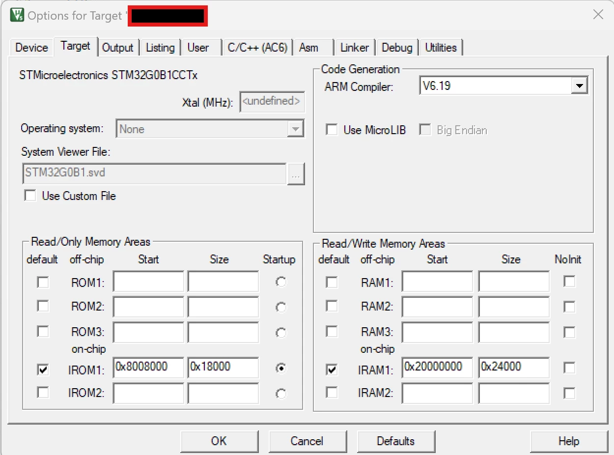

3.b. I changed the linker settings (under "Options for Target...") by updating the ROM1 start address to 0x08008000, as shown below:
I have verified through the debugger that the program counter (PC) successfully jumps to the main application’s main() function, and SCB->VTOR is set to the 0x08008000 address.
When I revert the vector offset and linker file changes in the main application (i.e., running the main application at the 0x08000000 address without Bootloader), everything works as expected, and the interrupts are invoked correctly.\\

Use the debugger to check the actual value loaded to VTOR register in your app startup.
VTOR value should be set to 0x8008000.
My guess:
FLASH BASE is 0x8008000 and VECT_TAB_OFFSET is 0x8000, so the resulting incorrect value of VTOR is 0x8010000.
Leave VECT_TAB_OFFSET at 0.
Too much "intelligence" in that startup code... ;)

The problem in my case was something with the de-initialization of the peripherals. Cause when I run the application using CubeIDE (downloading and starting from application start) it works fine.
I worked around this by setting a flag in flash and running a NVIC_SystemReset(); and first thing I do in main is checking for that flag if set then boot will jump to application and every thing is works.
I think this should mean that my de-initialization is missed up :grinning_face_with_sweat:.
