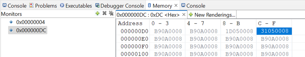

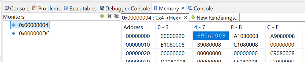

As per CM4 guide and TRM of Nucleo f446re,interruot vector table is array of function pointers and each pointer holds the entry address(initial address) of each IRQ_handler, Where interrupt IRQ_number is used for indexing.

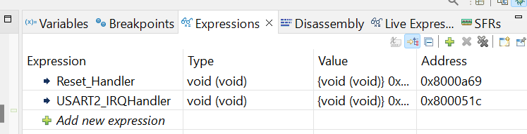

While debugging I failed to observe the intial address of teh reset handler and USART2_Handler at location 0x0000 0004 and 0x0000 00DC respectively.Please find the samething in attachments.Address fo the IRQ_handlers are available in expressions window snapshot and actuall value stored at location 0x0000 0004 and 0x0000 00DC is not matching.
Am I missing something here?
I am just verifying my understanding -->"At each location in IVTable,address oif IRQ handlers should be ther (&<IRQ_Handler_Name>Screenshot 2025-05-14 222309.png

What function is at 0x08000530 ? The ODD version is jump the +1 indicating the code is THUMB/16-BIT

The renderings seem to be in the wrong endianess, so 690A0008 reads 0x08000A69 (match!) and the other handler seems to be one word to the left: 1D050008 -> 0x0800051D. The least significant bit indicates a branch to thumb mode code.

in the Memory View: New Renderings... -> Hex Integer

That there is a configuration item that controls how the hex data is presented in the memory dump. It doesn't change what's in memory.
You could also print out the vector table as an array of 32-bit unsigned into. Use the serial console and printf() to format as desired.
