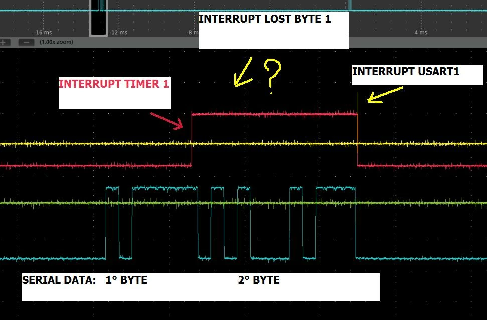

Good morning, I have some problems with interrupt priority on the STM32F429.

I also set a TIM1 timer with this priority.

Although the serial priority is greater than the timer priority, if I am executing the timer interrupt routine (lasting about 200usec), I have verified that when I receive data via serial at 57600,N,8,1 (and therefore a byte every 156us ) the data is lost because it does not enter the serial interrupt routine.
Why does this happen?

> NVIC_InitStructure.NVIC_IRQChannelSubPriority = 1;
The typical configuration has 4 bits for preemption and 0 bits for subpriority, which makes this setting invalid. Have you changed the defaults?
Perhaps show what NVIC_Init does. It's not a standard function as far as I can tell.

I solved it by calling the function
NVIC_PriorityGroupConfig(NVIC_PriorityGroup_2);
before initialization!!
