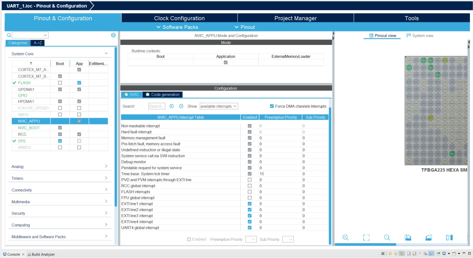

I am currently working with the STM32H7S78-DK board using STM32CubeIDE for setup. I have connected four external buttons to the following pins: D2 (PF1), D4 (PF2), D7 (PF3), and D8 (PF4) on the board.
I have configured the buttons as external interrupts. However, while I am able to detect button presses in the main loop by polling the GPIO pins, the interrupt does not seem to trigger the HAL_GPIO_EXTI_Callback(uint16_t GPIO_Pin) function.

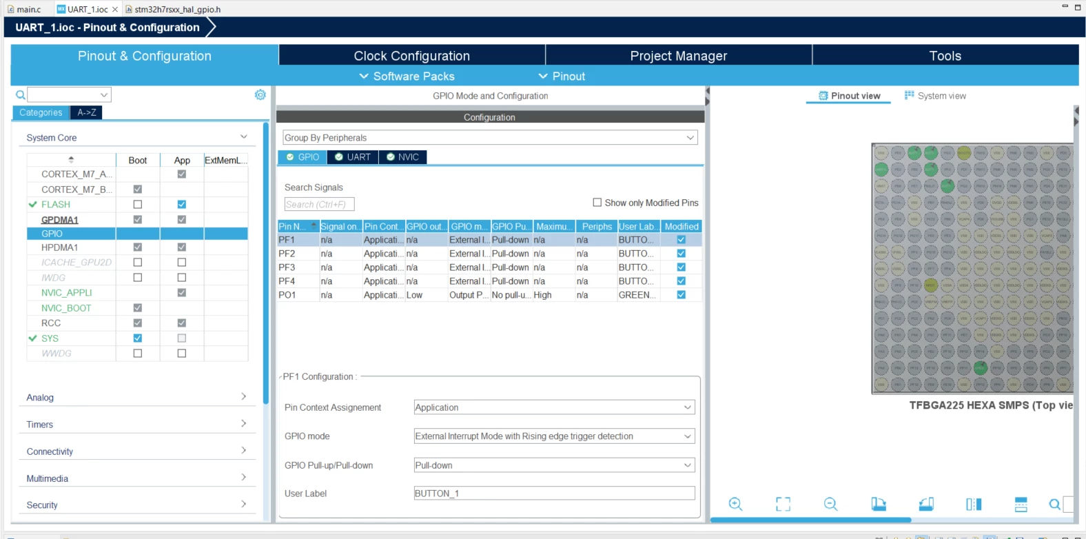

Steps I have followed:
- Configured GPIO pins (PF1, PF2, PF3, PF4) as interrupt inputs in STM32CubeMX.
- Enabled the interrupts in the NVIC configuration.
- Implemented the HAL_GPIO_EXTI_Callback function in the code.
- Used GPIO_MODE_IT_RISING for interrupt triggering.
Despite the above configurations, the interrupt Callback is not being invoked when the buttons are pressed.
Here I attached some snapshot of configuration and code i have write.

 /*Configure GPIO pins : BUTTON_3_Pin BUTTON_2_Pin BUTTON_4_Pin BUTTON_1_Pin */
 GPIO_InitStruct.Pin = BUTTON_3_Pin|BUTTON_2_Pin|BUTTON_4_Pin|BUTTON_1_Pin;
 GPIO_InitStruct.Mode = GPIO_MODE_IT_RISING;
 GPIO_InitStruct.Pull = GPIO_PULLDOWN;
 HAL_GPIO_Init(GPIOF, &GPIO_InitStruct);

mƎALLEm
mƎALLEmBest answer
Dec 24, 2024 11:51 AM UTC
Getting back to you regarding this subject. It seems  the call of __HAL_RCC_SBS_CLK_ENABLE() was not generated by CubeMx.
Please add it manually in HAL_MspInit() in stm32h7rsxx_hal_msp.c file:
void HAL_MspInit(void)
 /* USER CODE BEGIN MspInit 0 */
 /* USER CODE END MspInit 0 */
 /* System interrupt init*/
 /* Enable the XSPIM_P1 interface */
 HAL_PWREx_EnableXSPIM1();
 /* USER CODE BEGIN MspInit 1 */
 __HAL_RCC_SBS_CLK_ENABLE();
 /* USER CODE END MspInit 1 */
 Hope that answers your question.
In meantime the team is working on it.
11 replies

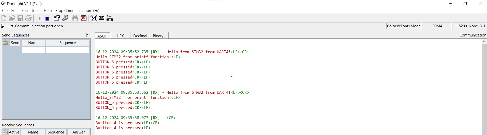

Dec 16, 2024 4:36 AM UTC
After loading the program, an interrupt is generated without pressing the USER button (PC13) at starting. However, after pressing the button, no interrupt is generated. It is only detected by for loop "Button 4 is pressed".
here is my code,
