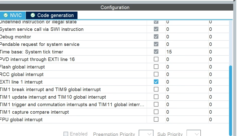

actually I'm using stm32F446RE, I'm using hal library just to detect external interrupt from PA1 pin but it doesn't work, and if I put the interrupt from PA0 pin, it works fine?
/* USER CODE BEGIN 0 */
 void HAL_GPIO_EXTI_Callback(uint16_t GPIO_Pin)
 count++;
int main(void)
 HAL_Init();
 SystemClock_Config();
 MX_GPIO_Init();
 MX_TIM1_Init();
 while (1)
void MX_GPIO_Init(void)
 /* GPIO Ports Clock Enable */
 __HAL_RCC_GPIOH_CLK_ENABLE();
 __HAL_RCC_GPIOA_CLK_ENABLE();
 /*Configure GPIO pin : PA1 */
 GPIO_InitStruct.Pin = GPIO_PIN_1;
 GPIO_InitStruct.Mode = GPIO_MODE_IT_FALLING;
 HAL_GPIO_Init(GPIOA, &GPIO_InitStruct);
 /* EXTI interrupt init*/
 HAL_NVIC_SetPriority(EXTI1_IRQn, 0, 0);
 HAL_NVIC_EnableIRQ(EXTI1_IRQn);
Best answer by kkhli.1
thx for your answers @Sarra.S​ @Community member​ , i just replaced the stm card and it works
the pb that the pin PA1 is burnt

Hello @kkhli.1​,
Check that the EXTI1_IRQ interrupt is not being masked by other interrupts with higher priorities
kkhli.1
kkhli.1Author
May 4, 2023
hello ,i'm using only one interrupt
waclawek.jan
May 4, 2023
Make sure you have connection from physical PA1 pin to the point you think the signal is. Observe input in GPIOA_IDR, or set PA1 as output and toggle.
Read out and check EXTI and relevant GPIO and SYSCFG registers content.
Other than that, follow the usual "interrupt does not fire" checklist.
kkhli.1
kkhli.1AuthorBest answer
May 4, 2023
