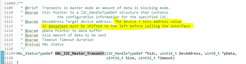

uint16_t Device_Add = 36 << 1;

Thanks Karl,
Master is sending the data to slave, slave received the data in while(1).
But we want to receive data on interrupt basis.
during debugging none of the following functions were called in receive or transmit condition.
HAL_I2C_MasterRxCpltCallback()
HAL_I2C_MasterTxCpltCallback()
HAL_I2C_SlaveRxCpltCallback()
HAL_I2C_SlaveTxCpltCallback{()
Pls help us to get data on interrupt.
code of both controller was attached with the original post
