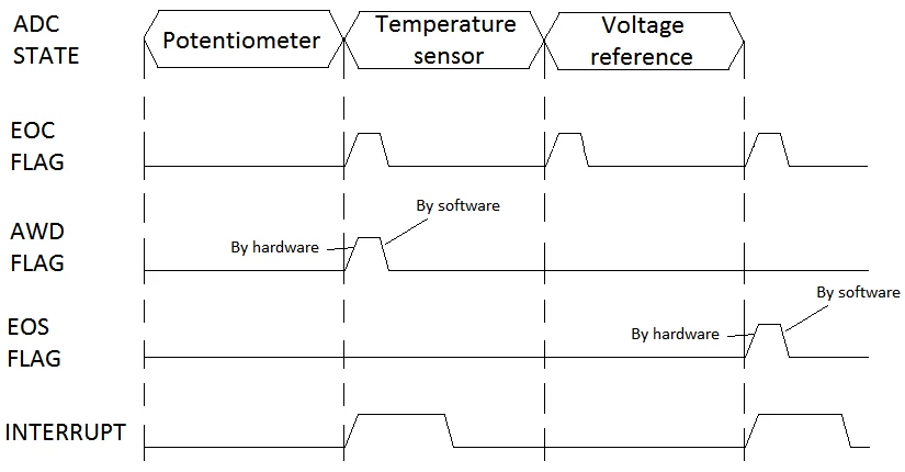

I have a Nucleo board with stm32f302r8. I want to set a state variable for voltage window:
state = STATE_OK if higher threshold > current voltage >  lower threshold
state = STATE_AWD if higher threshold < current voltage or lower threshold > current voltage.
I set up a ADC1 with AWD1 and enable interrupt for AWD1 and EOS flags.
My handler:
void ADC1_IRQHandler(void)
   // debug_send(NVIC_GetPendingIRQ(ADC1_IRQn)); //simple uart sender
   if (ADC1->ISR & ADC_ISR_AWD1) {
      // Exclude the cause of the interrupt
      ADC1->ISR |= ADC_ISR_AWD1;
      state = STATE_AWD;
   } else {
      state = STATE_OK;
   ADC1->ISR |= ADC_ISR_EOS; // Exclude the cause of the interrupt
   debug_send(state); // simple uart sender
If current voltage has a permissible value then generated only one interrupt.
If current voltage has not a permissible value then generated TWO interrupt:
  1. for AWD1 flag
  2. for EOS flag
I try to read ISPR register (using CMSIS function NVIC_GetPendingIRQ()) and problem disappeared: always generated only one interrupt.
Why?

I understood.
I have a three ADC conversion:
  1. Potentiometer
  2. Temperature sensor
  3. Internal voltage reference
I have a two flag which generates interrupt:
  1. AWD flag
  2. EOS flag
AWD flag is generated at the same time as the EOC flag. Timing diagram:
Because is generated two interrupts.
Conversion:
  1. DISABLE interrupt from AWD flag.
  2. Clear AWD flag in handler from EOS flag.
ADC Handler:
      ADC1->ISR |= ADC_ISR_AWD1; // Clear flag
      state = STATE_AWD;
   } else {
      state = STATE_OK;
   debug_send(state); // uart sender
1 reply
