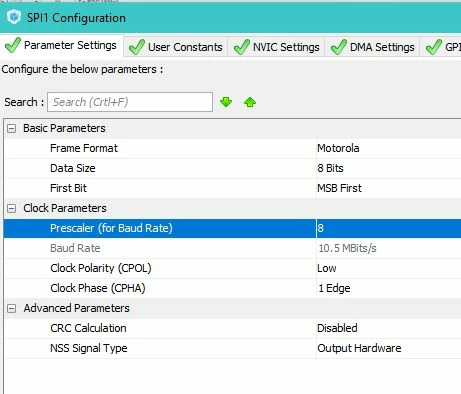

    my initialization of SPI :
    void MX_SPI1_Init(void)
    hspi1.Instance = SPI1;
    hspi1.Init.Mode = SPI_MODE_MASTER;
    hspi1.Init.Direction = SPI_DIRECTION_2LINES;
    hspi1.Init.DataSize = SPI_DATASIZE_8BIT;
    hspi1.Init.CLKPolarity = SPI_POLARITY_LOW;
    hspi1.Init.CLKPhase = SPI_PHASE_1EDGE;
    hspi1.Init.NSS = SPI_NSS_HARD_OUTPUT;
    hspi1.Init.BaudRatePrescaler = SPI_BAUDRATEPRESCALER_2;
    hspi1.Init.FirstBit = SPI_FIRSTBIT_MSB;
    hspi1.Init.TIMode = SPI_TIMODE_DISABLED;
    hspi1.Init.CRCCalculation = SPI_CRCCALCULATION_DISABLED;
    hspi1.Init.CRCPolynomial = 10;
    HAL_SPI_Init(&hspi1);

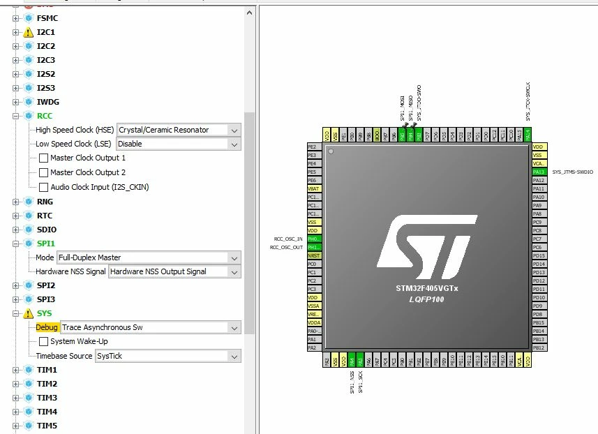

    I am using
    Cubemx,
    IDE:Keil 5
    MCU:STM32F405 (using inbuilt SPI-1 engine).
    Flash Memory:Atmel AT45DB041
    MCU PIN's:
    /**SPI1 GPIO Configuration
    PA4 ------> SPI1_NSS
    PA5 ------> SPI1_SCK
    PB4 ------> SPI1_MISO
    PB5 ------> SPI1_MOSI
    GPIO_InitStruct.Pin = GPIO_PIN_4|GPIO_PIN_5;
    GPIO_InitStruct.Speed = GPIO_SPEED_HIGH;
    GPIO_InitStruct.Alternate = GPIO_AF5_SPI1;
    HAL_GPIO_Init(GPIOA, &GPIO_InitStruct);
    HAL_GPIO_Init(GPIOB, &GPIO_InitStruct);

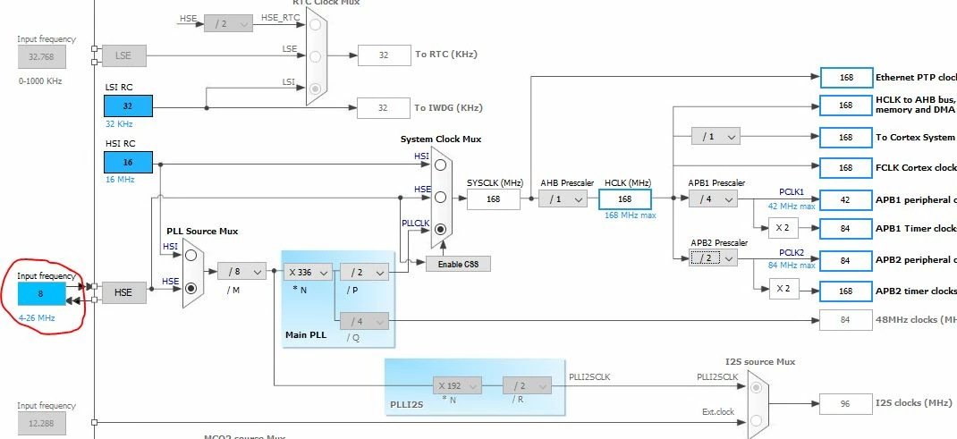

    void SystemClock_Config(void)
    RCC_OscInitTypeDef RCC_OscInitStruct;
    RCC_ClkInitTypeDef RCC_ClkInitStruct;
    __PWR_CLK_ENABLE();
    __HAL_PWR_VOLTAGESCALING_CONFIG(PWR_REGULATOR_VOLTAGE_SCALE1);
    RCC_OscInitStruct.OscillatorType = RCC_OSCILLATORTYPE_HSE;
    RCC_OscInitStruct.HSEState = RCC_HSE_ON;
    RCC_OscInitStruct.PLL.PLLSource = RCC_PLLSOURCE_HSE;
    RCC_OscInitStruct.PLL.PLLM = 2;
    RCC_OscInitStruct.PLL.PLLN = 3;
    RCC_OscInitStruct.PLL.PLLP = RCC_PLLP_DIV2;
    RCC_OscInitStruct.PLL.PLLQ = 5;
    HAL_RCC_OscConfig(&RCC_OscInitStruct);
    RCC_ClkInitStruct.SYSCLKSource = RCC_SYSCLKSOURCE_HSE;
    RCC_ClkInitStruct.APB1CLKDivider = RCC_HCLK_DIV1;
    RCC_ClkInitStruct.APB2CLKDivider = RCC_HCLK_DIV1;
    HAL_RCC_ClockConfig(&RCC_ClkInitStruct, FLASH_LATENCY_0);
    HAL_SYSTICK_Config(HAL_RCC_GetHCLKFreq()/1000);
    HAL_SYSTICK_CLKSourceConfig(SYSTICK_CLKSOURCE_HCLK);
    /* SysTick_IRQn interrupt configuration */
    HAL_NVIC_SetPriority(SysTick_IRQn, 0, 0);

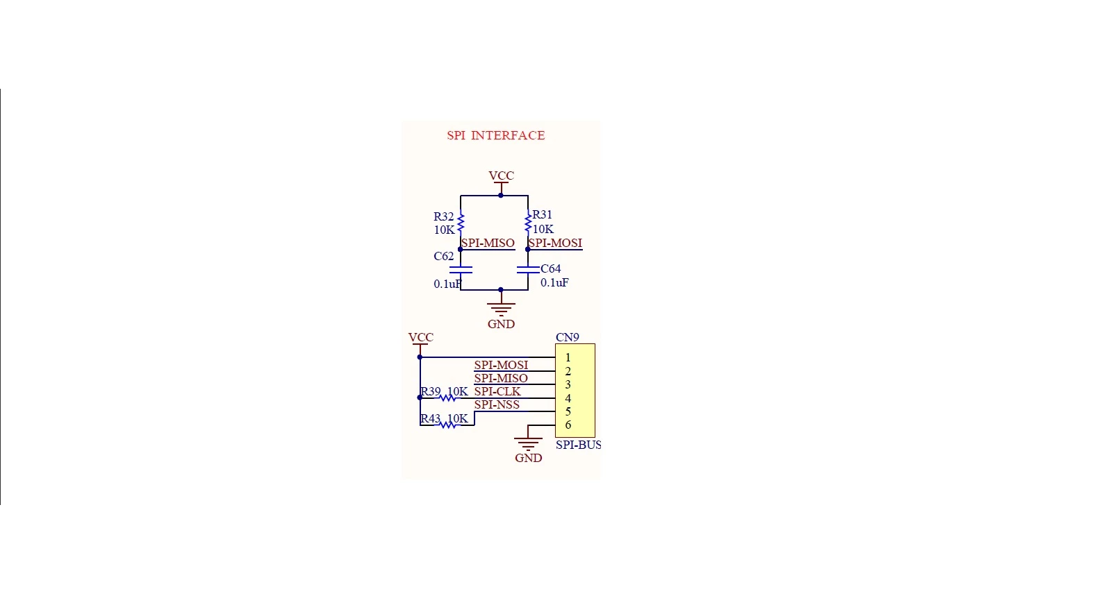

    Please refer above attached schematic.

    Vangelis Fortounas
    July 27, 2017
    Posted on July 27, 2017 at 14:26
    Hi Again!.
    Sandeep i dont understand how this initialisation code produced.
    RCC_OscInitStruct.PLL.PLLN = 3; // can 't be 3
    does not have any sense .
    Begin from Basics .
    Make a project at STM32CubeMX with your device (exact type)
    put the value of your crystal in MHZ in the blue box and set clocks (eg like this)
    And initialize your spi port
    Make some other settings to produce code for KEIL
    and generate the source projet
    fully initialized
    with theese setings
