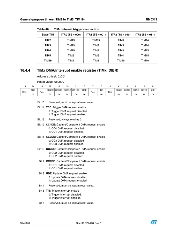

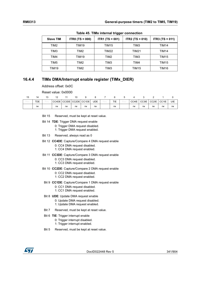

Hello,I'm using STM32F373CBT6 in my project and I've  noticed that TIM3 is triggered by TIM19 when ITR=0 and not TIM2 as stated in table 45, page 341 of RM0313 Reference manual. I checked the errata notes and didn't find anything relevant.Anyone had this issue before/can verify?Thanks,Stratos

    That table is a bad joke - there are no TIM21 and TIM22 in 'F373 either.
    This was in rev.1 of the same RM. Spot the differences.
    It's a shame that users replace ST's document quality control.

    Hi
    stratos_hatz
    Waclawek.Jan
    First sorry for loosing this discussion in all the ones we have and managing it so late.
    I have just reviewed it again and agree with you that the current content of the table 'TIMx internal trigger connection' in RM0
    It is reported and should be fixed in next revision of RM0
    -Amel
