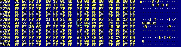

Hi all
I've some troubles with the internal temperatur sensor from my stm32f051: If I read the adc_channel16 I get ~1920 as value.
Then I calculate the result in this way
�C = ((V25 - VSENSE) / Avg_Slope) + 25 = ((1.43V - 1.54V) / 4.3mV/�C) + 25 = -0.58�C
But this should be ~22�C.
Then I thought, that I could use the factory callibration data. But HOW?
If I read the stored value like this ''(*((uint32_t*)0x1FFFF7B8))'' I get 100206271 as ''
TS ADC raw data acquired at temperature of 30 �C, V
DDA
= 3.3 V
So can anyone help me? Or should I use an external SPI temperature sensor for only measuring with an accuracy of ~1�C?

The 30 C and 110 C calibration values are 16-bit, not 32-bit

Tesla DeLorean
Guru
May 16, 2013
Posted on May 16, 2013 at 18:13
But why are they using 2 32Bit registers for each value?
You are confused, they do not, it describes two addresses for 8-bit bytes, which when combined represent a 16-bit value. The range no doubt fitting in 12-bit given the performance of the ADC.
uint16_t ts_cal1, ts_cal2;
ts_cal1 = *((uint16_t*)0x1FFFF7B8);
ts_cal2 = *((uint16_t*)0x1FFFF7C2);
from these you should be able to create a basis, and per degree scale from which to utilize the reading.

Ok, I've now changed my calculation but the values isn't still correct (SMT32F0Discovery).

I've changed the formula from (((V25 - VSense) / Avg_Slope) + 25) to (((ADC30 - ADC) / Avg_ADC_Slope) + 30). With this values: ADC30 (TS_Cal1) = 1727 ADC (room temp) = ~1940 Avg_ADC_Slope = 5.3125 This gives a Temperature of -10°C instead of ~22°C. What I'm doing worng?
damh
May 17, 2013
Posted on May 17, 2013 at 11:38
Check Vcc and Vcc_ref. If they are not equal to accurate 3.3V, you have to calculate this difference away! Vcc_ref should be stable, too!
Your value of 1940 at 22°C seems to be measured at Vcc_ref=3.0V ;)
1940 / 3300mV * 3000mV = 1763 (corrected ADC_Value) => 23°C
pa_it
pa_itAuthor
May 17, 2013
Posted on May 17, 2013 at 12:52
Thank you. The discovery board use realy 3V instead of 3V3.
Problem solved.
