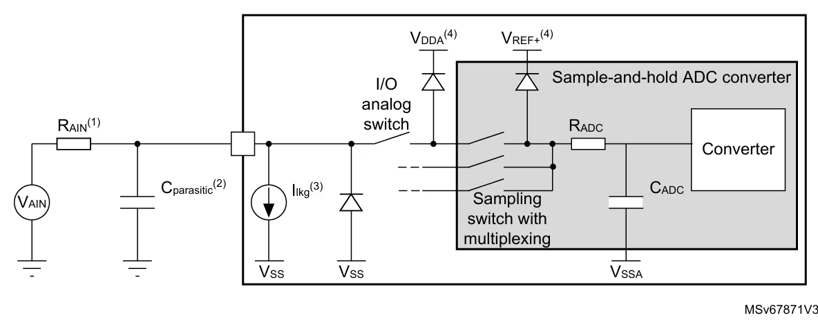

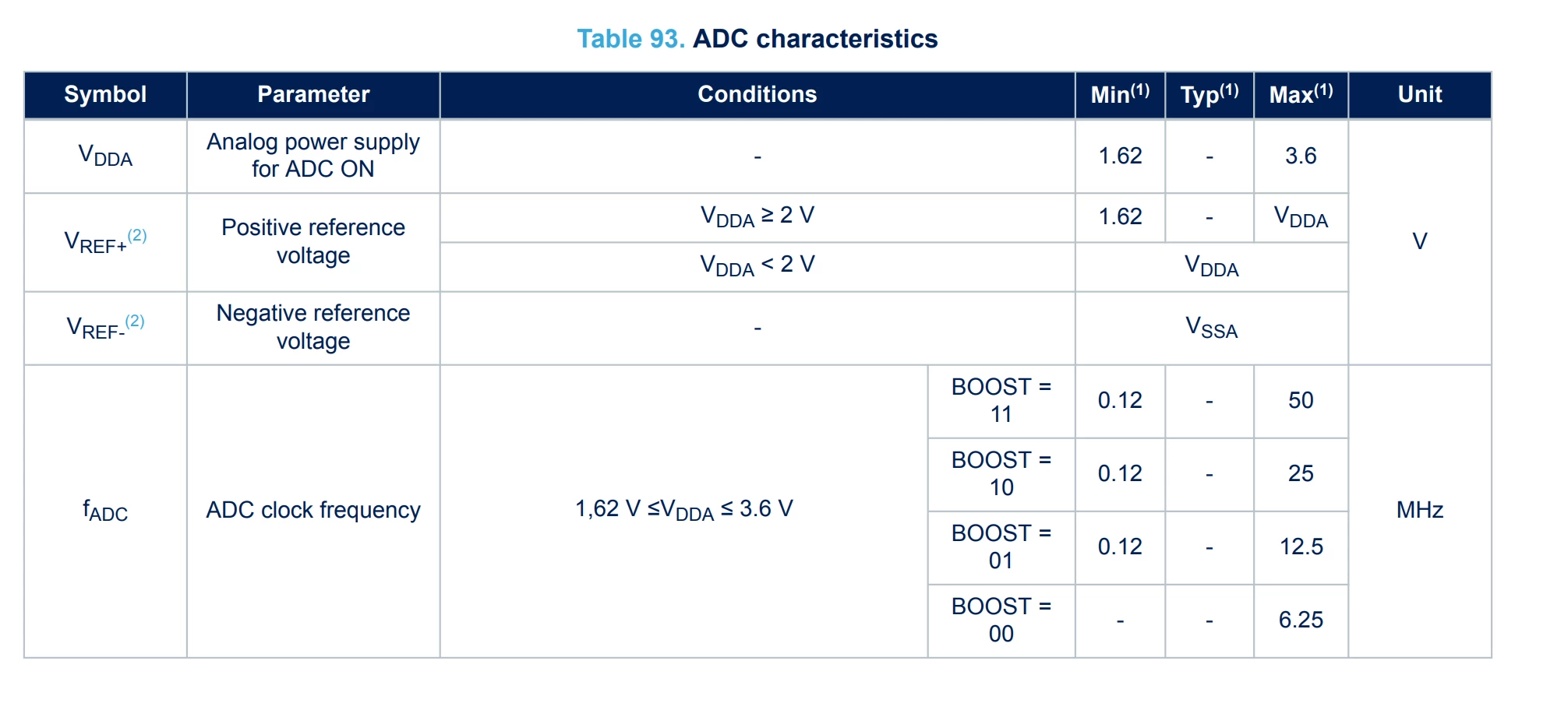

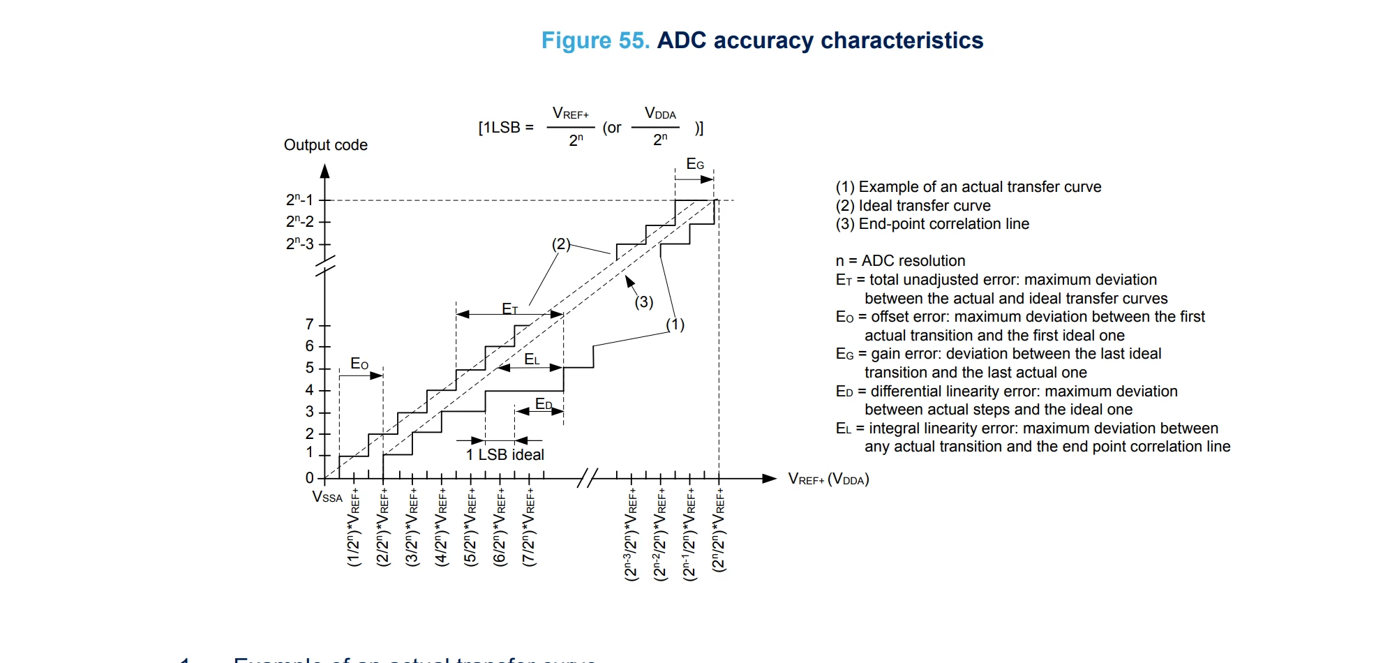

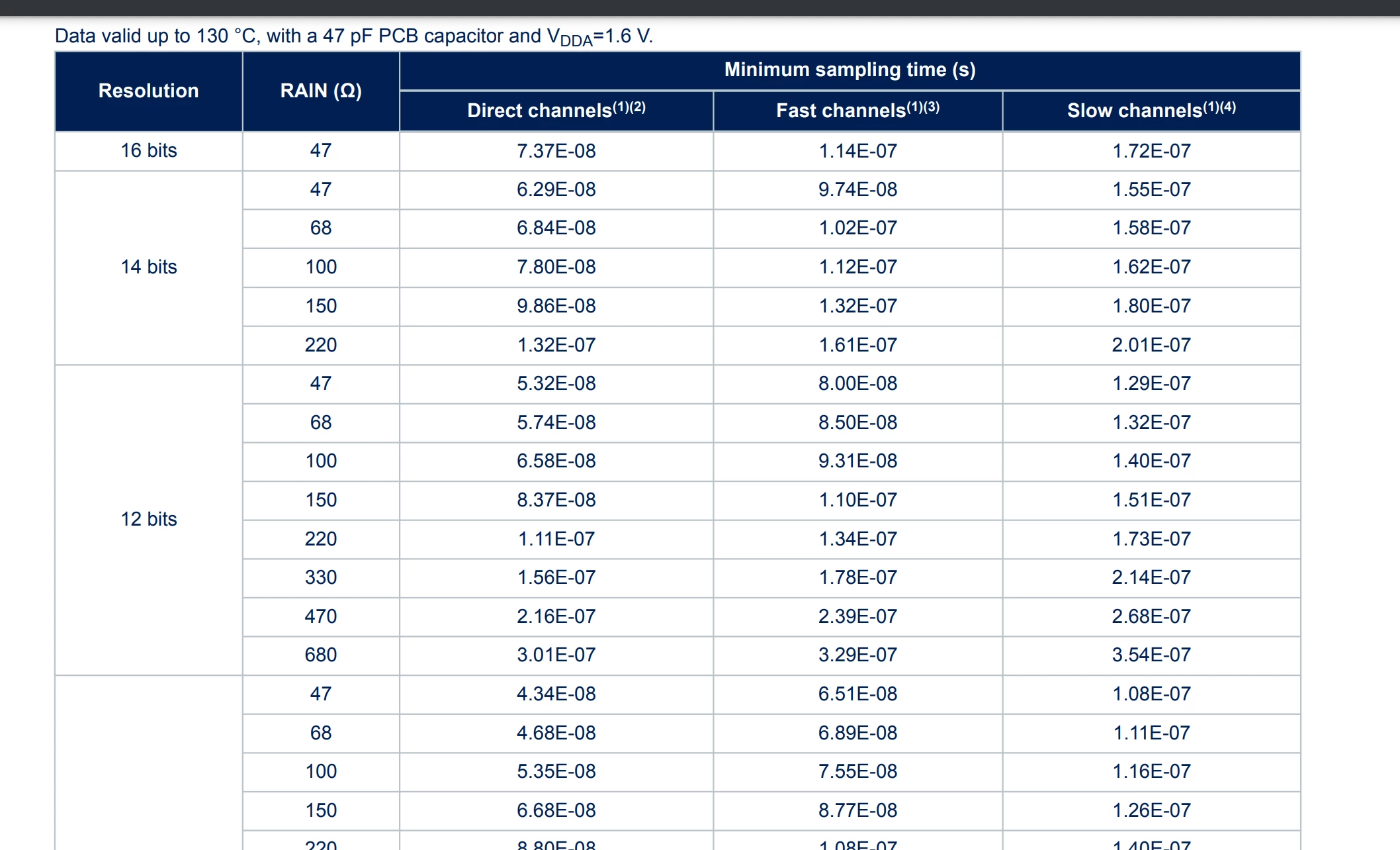

Good morning. I am working with the Discovery kit with STM32H7B3LI MCU and want to get its internal resistance. I want to use 10 buttons, each with one resistance, and then get the correct value for my MCU. I already know how to get the values between 12000 and 64000. but I do not get what Voltage they describe. I saw on the datasheet of the Chip that it has a linear relation with the voltage and receives a voltage between 1.62 and 3.6V. Still, I have no accurate Information on the internal resistance to calculate my voltage divider. I can do it with the information I have, but I feel like I am missing something. When I put a 120-ohm resistance or shortcut directly to the ADC with 3.3V, it also gives me the maximum value.

    The convertible input range for the ADC is (0, VREF+) which is typically (0, VDD). It sounds like your board has VREF+ = 3.3V.

    The ADC doesn't have a resistor to ground. You can't use it as one half of a resistor divider. It has some effective series resistances and capacitances.
    See here for the effective circuit:
    You can do what you're doing, but you will need to use external resistors and have the voltage of the net change based upon what button is being pressed.

    ok so i will add a pull down resistance then. Does the value then will go until 3,6V? because i still do not understand why i get the max value when I send 3,3V
