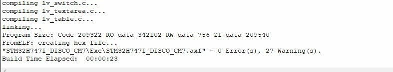

I am using STM32H747 Discovery board in that I am using TFT display using LVGL in code my RAM is taking space upto 250 KB and my code is going in hardfault_handler();

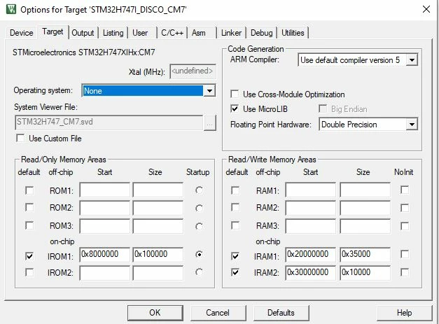

Why's it Hard Faulting? You're describing memory you don't have?
Are you allocating dynamic memory and ignoring the failure there?
Can you use the SDRAM on the board?
Does 0x20000000 have 0x35000 bytes, or only 0x20000 ?
0x24000000 has 0x80000 (512KB)
0x30000000 has 0x48000 (128+128+32)

Examine the map file (aka "linker listing") to see what's using all the memory?

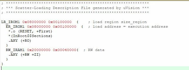

Dec 12, 2024 10:18 AM UTC
Is my scatter file setting is correct for stm32h747

Please see this for how to properly post source code and other "formatted" text (scatter files, etc) - not as images:
